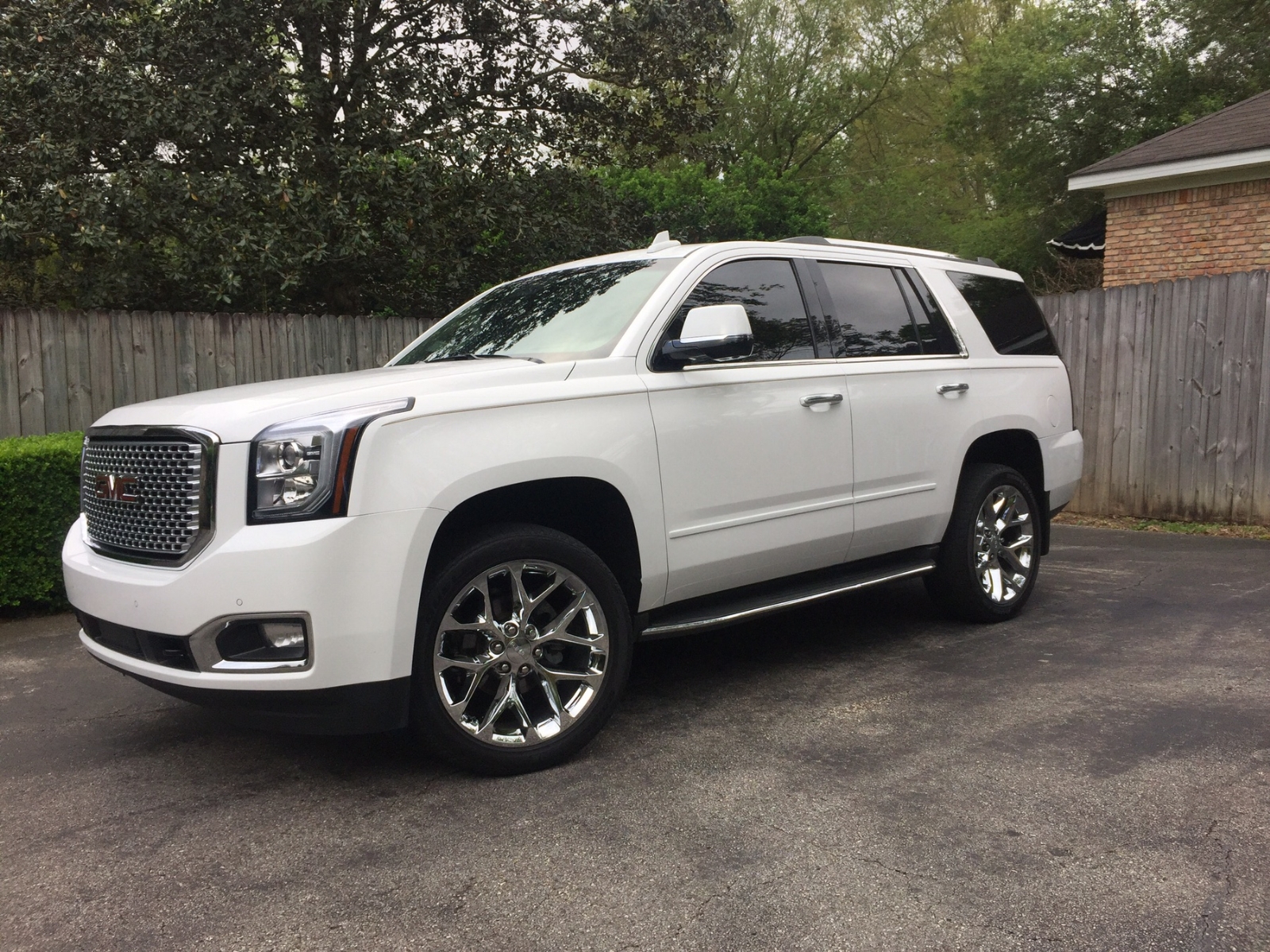

Escalade side mirrors on a Tahoe LTZ!

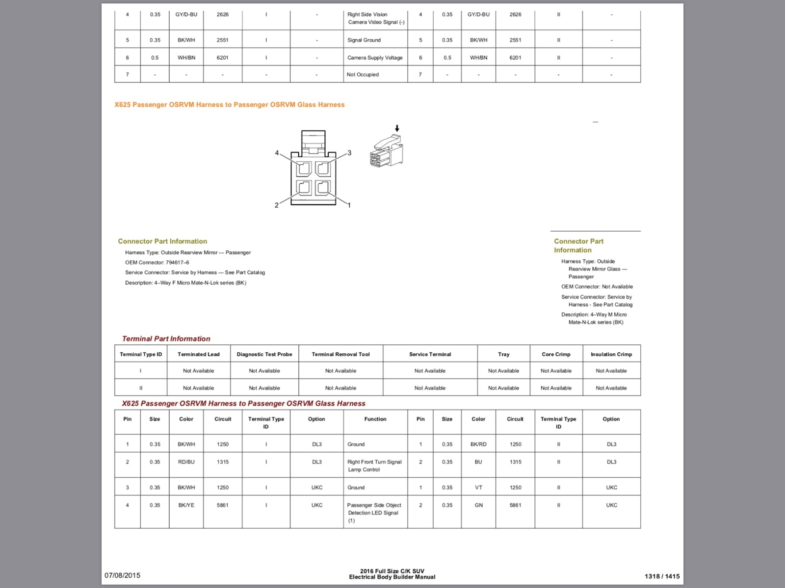

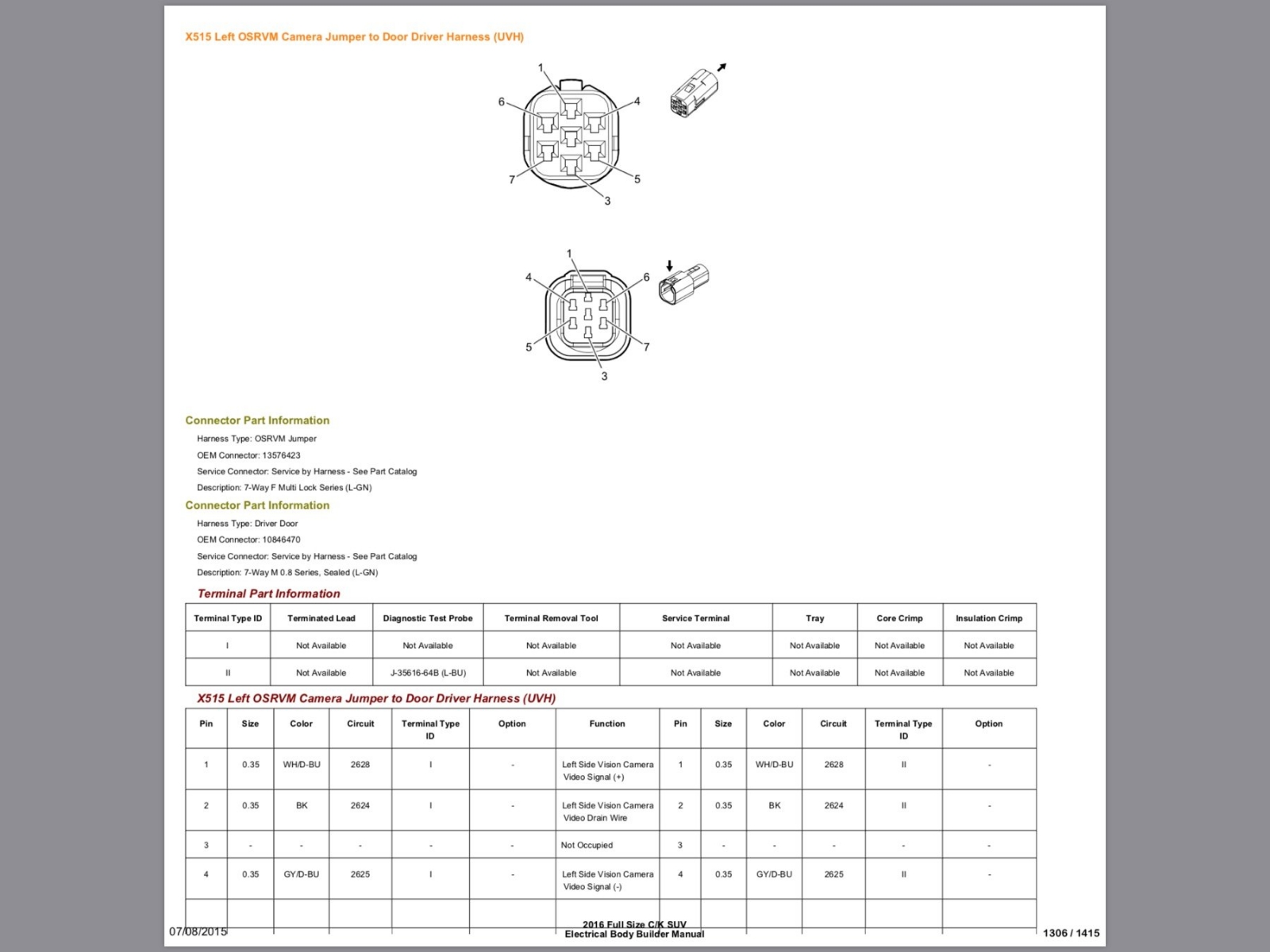

+1. I've added the door harness but without the illuminated handle so was able to get around that. However ran into the same issue of the body side wires not being present. I guess it was too much to hope for them to use one pn for the behind the dash harness. Same with the grille camera. I have the esky grille harness and stripped the wires out to run independently to my grille plug (there was a lot more different about the esky front end than the tahoe plug wise to simply use the esky harness) however there are no body side connections. So i'm stalled trying to figure out how to get all that setup. I managed to find a used video processing module on eBay but my cadillac guy is unsure if it would require any additional programming or not. The mirrors are still a success from a look and function perspective but the 360 is starting to look like more trouble than it's worth.
I wonder if you would be able to wire the Cadillac mirror cameras to an aftermarket unit, like the Rostra 250-8450:
http://www.rostra.com/chevrolet-gmc-blindspot-front-camera.php
You would still need the body wiring, but this would only entail one or two wires per side? I would think it would make life much easier than trying to mate Cadillac with Chevrolet stuff. I would try that route (if I had the money and parts!).
