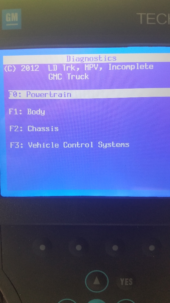

I am thinking I am not going to get to the bottom of this issue. Glad I got the Tech 2 to reset it to 3% when it gets up into the 30’s percentage range. :(
