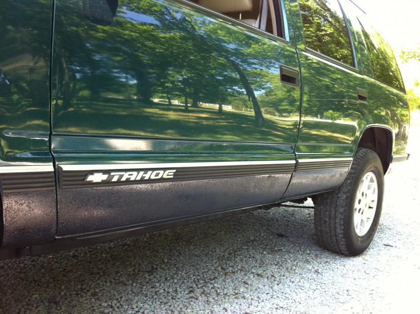

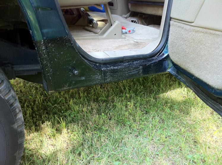

Here's a pic of a bumper coated in Sem Chip Guard:
I might be able to spray the rockers with the Chip Guard and just leave the flares alone.
Casey

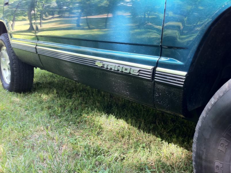

Here's another pic of Sem Chip Guard; this one is on the rocker panels of a Dodge pickup:
Casey
96ProCompTahoe
Apr 30, 2009
2,606
11
IN
that second picture is what i had invisioned texture wise for my rockers. how thick is that chip guard? may be a better option.
