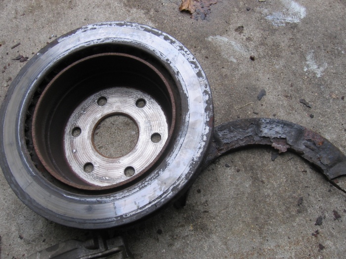

Finally got the rears done...
When I bought my used truck the prev owner said it had new brakes all around and judging by all the work orders for stuff and how clean and obviously maintained it was, I didnt think otherwise. Well this ****** would barely stop whenever the wheels got wet so I decided to take a better look at the brakes to figure out wtf was wrong.
I think something was wrong with this caliper/rotor. The pad was ground down flat on just 1 pad:rolf
This side was missing a pad and the piston(what was left of it) was stuck grinding on the rotor. That fragment was what was left of the back plate/disc cover.:wow
Besides the fact that the calipers bolts had to be cut away from the brackets, pistons were seized/blown out, bleeder screws were rounded/broke, and brake hoses were rusted and leaking somehow I dont think the brakes were ever done.:rolf and judging by how much this shit cost, I can see why:( anyways, finally done and next time I just might dissect the ******* thing in the driveway before I buy it!:rolf:goof

My rears kinda looked like that, and it turned out that the guy that I bought the truck from just put the pads on without turning the rotors. I don't know if the rotors were originals, but they had the GM stamp on them and I had about 150k on the odometer. They were pretty rusted and were eating the pads like crazy. The outside portion of the rotors looked normal, but the inside looked just like yours. So, I put some stockers and a little later the yellowstuff. The brake dust for me is a little more than ceramics.

this truck has 185k and it wouldnt surprise me if they were still stockers. I too used the yellowstuff pads for the new setup but with stainless brake lines and new oem rotors/calipers.
