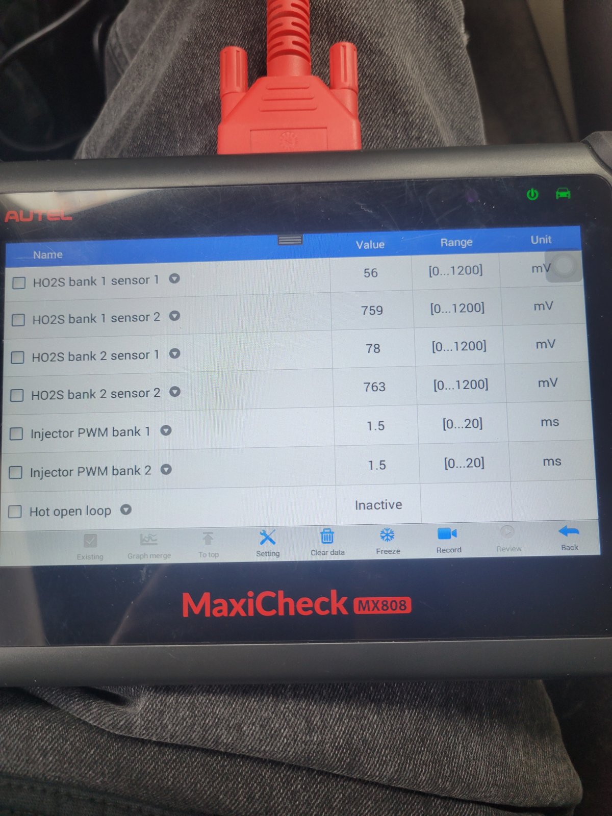

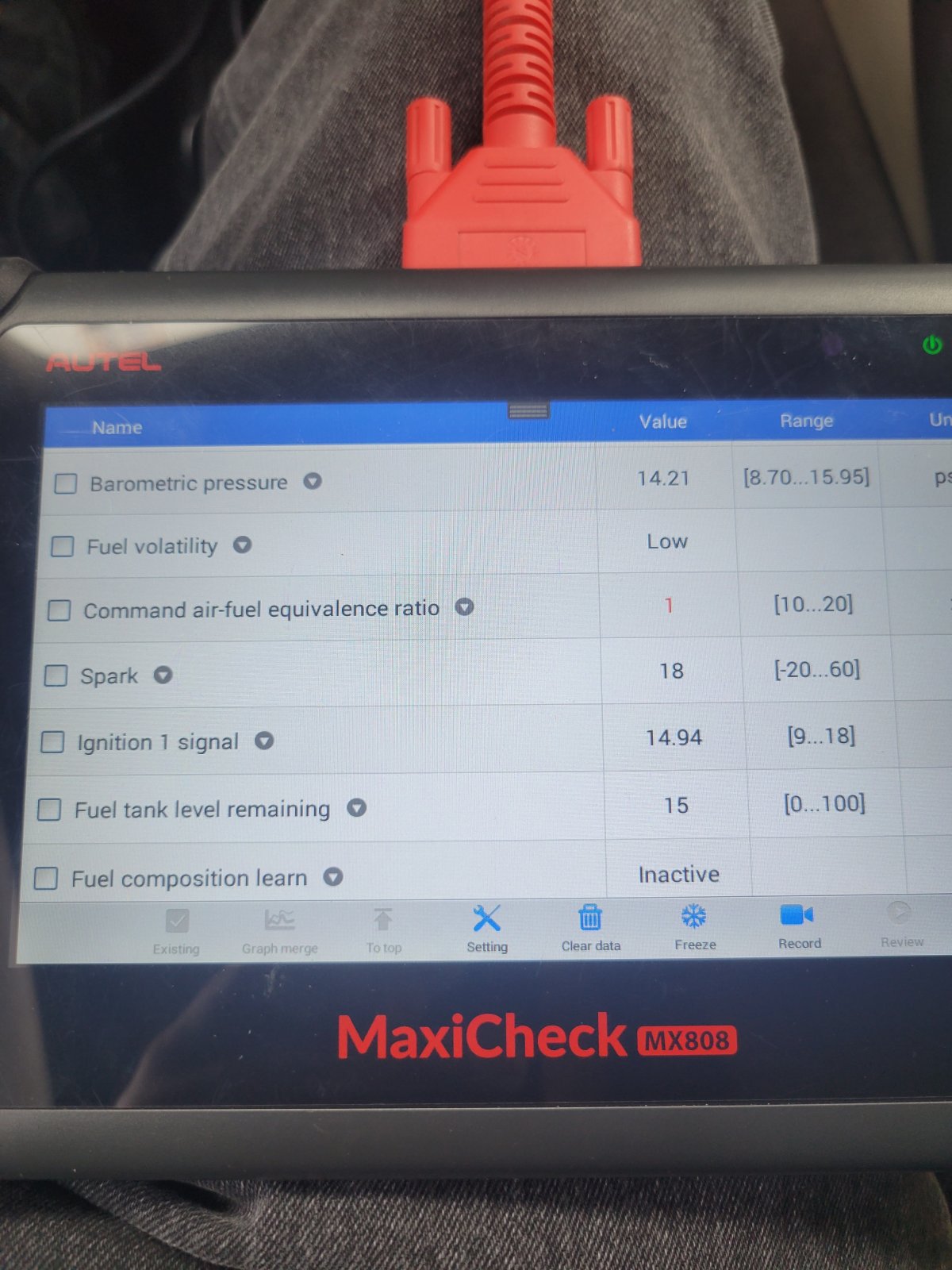

Nov 11, 2015
108
Continued
MAP test 1 shows fault
Fuel alcohol content is 80%
Comman A/F equivalence ratio 1 in RED
Loop status closed
Hot open loop inactive
All these are at operating temp 199.4

No, just standard premium from QT.
then that's your issue. it really common. you need a ton more fuel to run on e80. clear/reset that. it should run better.
after you should probably change plugs from being rich fouled, oil from being filled with fuel and o2 sensors because the ecm does math off them to come up with e%.

That's the odd thing, it runs great. Its only the flooding issue on first start up of the day. I did plan to do oil change and check plugs.
Not showing any codes to reset.
More fuel to run on e80?
