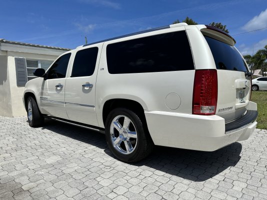

Finally got my son to break out the hose and wash the long body and dry it by himself. He did a great job.
I did the detailing, then showed him how to check the fluids.
He’s interested but not passionate….lol yet….

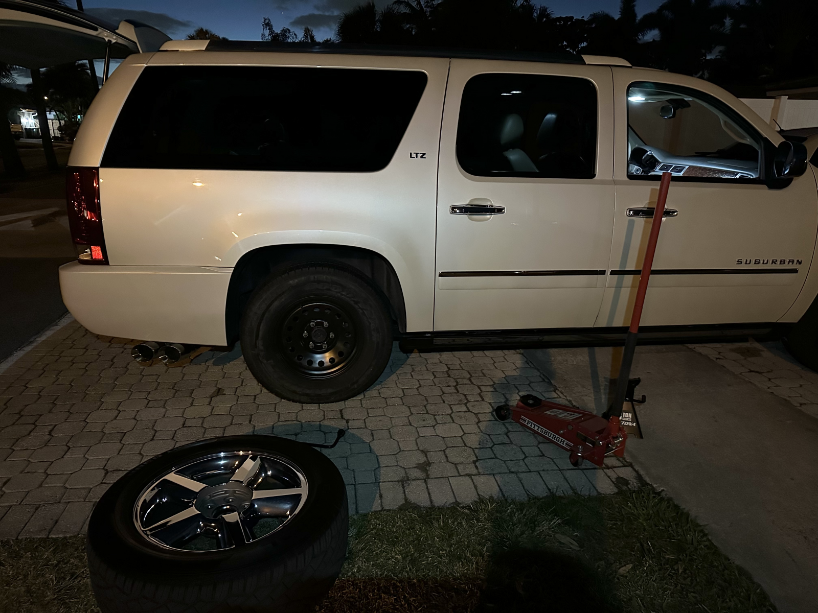

Fast forward 24 hours. Wife comes home with the kids and the DIC is showing low tire pressure and they saw something sticking out of the tire. WTF!!
2 spots. Looked like a nail in the middle of the tread and a broken off screw slowly dropping the pressure. Luckily the same tire.
Rather than have to deal with a flat tire in the morning, I backed the truck down over the sidewalk, so it was off the decline and lifted her up (of course a few people had to walk around with their dogs hahahaha). A big no-no in the neighborhood to block the sidewalk. Took longer to get it set up than to change out the spare.
Sent my buddy a message that my wife would be there for doors open at 0730 as I had to go to the airport at 1100. Wife got there at 0715 and there were already 5-6 people waiting in line to get service. The Suburban was home in 1 hour. Thanks man!
Maybe I should just rock the spare tire look?

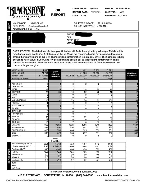

Did some detail work to the long body. Polished and sealed the paint and chrome. Cleaned the engine bay. Hit the seats twice because whoa...been a long time. They are looking much betterer.
Still thinking about a change in wheels in the near future, but stuck on which GM 22s to go with...:emotions34::boti:
Also got the Blackstone oil analysis back and pretty happy with that report.
