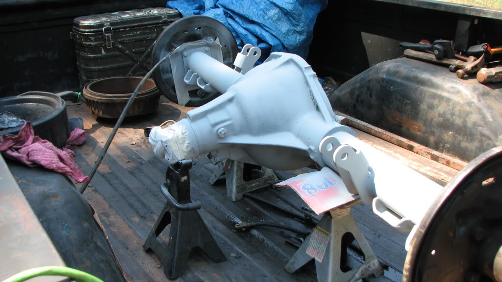

Anyway, got the drums off and shot the tubes, cover, and housing with primer so it would stop rusting. Now, I need to replace a few lug studs that have damaged threads, install new brake shoes and hardware, paint (flat black), fill with oil, and get it in my truck. Not enough time in the day.......
Make sure to give it abour 3 coats of chassis black to seal it . Bare primer will still rust underneath .

Oh yeah, I put a couple coats of black on it already. Just haven't had a photo opportunity yet. :)
