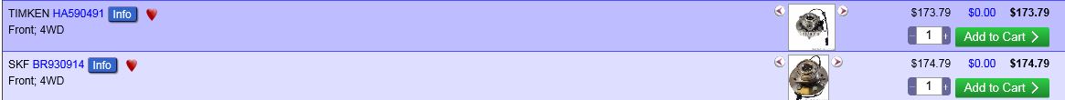

Anyone know the "right" price for a front hub?

i'm poor, jack it up, take wheel off, take 2 brake caliper bolts off put to side, take 3 bolts off hub. unclip abs harness, put new hub on, clip abs harness on, put 3 bolts on, put 2 bolts on brake caliper, put wheel back on. done
cost $177 (last time I purchased)
savings with 20 minutes of my time $600
4wd/awd involves one more step of 1 more bolt for the front axle, best done while wheel is still on the ground
difficultly level 2 out of 5, not hard at all
if rust is an issue use a bfh or torch
#tip's? turn wheel for easier access to bolts, use torque wrench during final re-assembly
