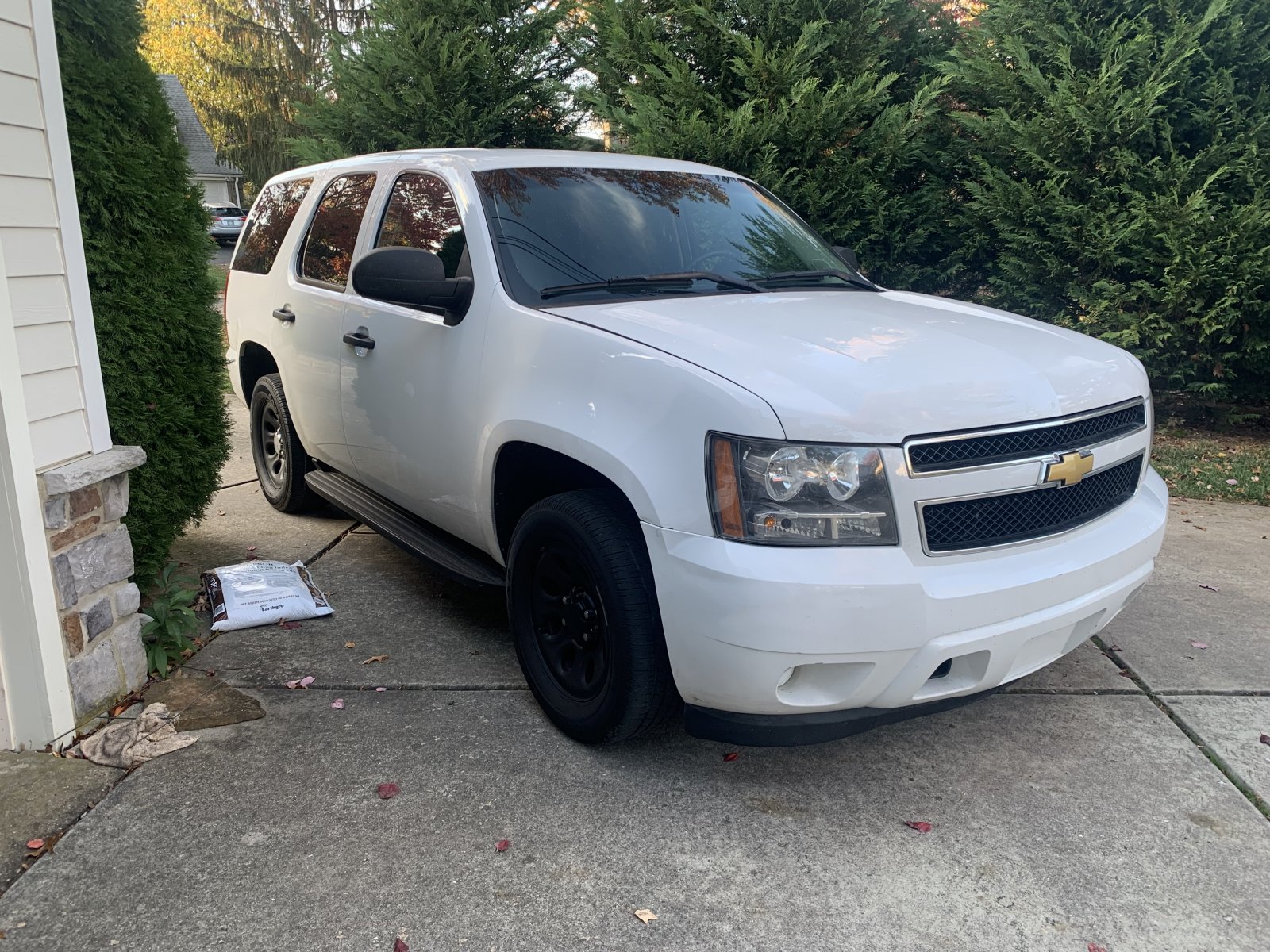

I now have a 2013 Tahoe PPV with 76k miles and need new struts.
In the case of Belltech 25004’s, as these are just the shocks and not coilover (shock + spring combo), does this mean I would re-use the springs and swap them onto the belltech‘s?
I am refreshing front suspension completely.
Thank you!!
