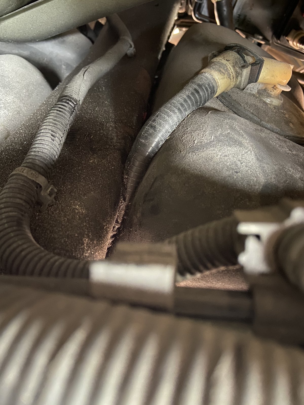

Where on the image below is the white valve you are taking about. I have never seen it.

If you are talking about the white cap like the picture shown below, that is not a valve it's just a vent. Did you blow the lines that go to the intake manifold?
Yes that’s the white cap I was talking about. Do they go bad are they serviceable? Lines on the intake? Is there more than one? The only one I blew out is the one that goes to the purge valve and the one that still produces pellets when hooked up and removed. If left unhooked no pellets.

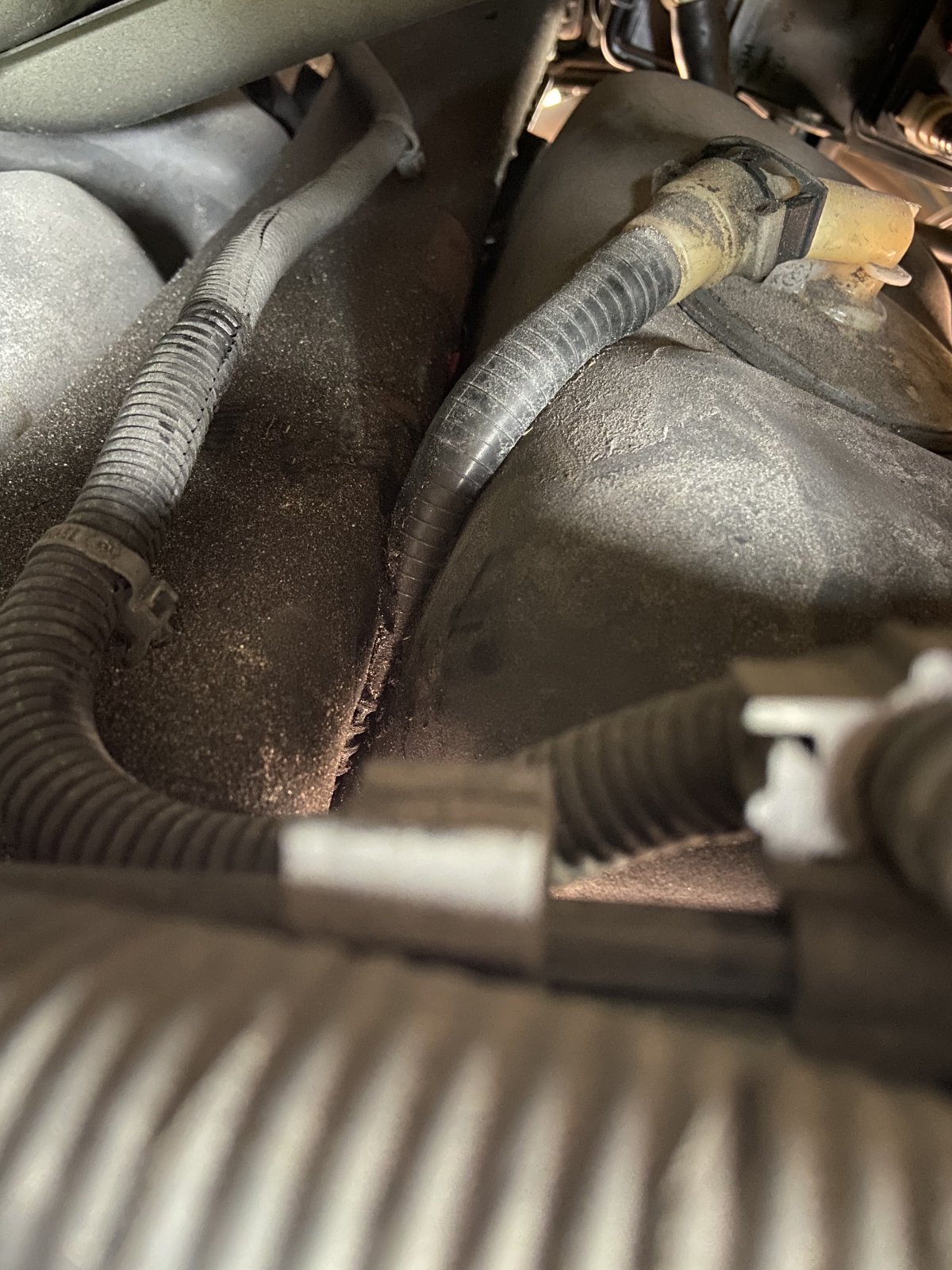

Post# 5 is not a SUV fuel tank it is the 26 gallon P/U tank. Post#6 and #8 is the correct tank, the external valves that your see that is white is GVV (Grade Vent Valve). If you look at the back of the tank that black disc that it is welded to the top is where the FLVV is located. And this is where the internal 5/8 line is plumbed to. That valve controls the height of the fuel and allows the tank to vent when filling. There may be an issue with this or the line is plugged, if that happens then you can not vent the tank,
Ok if it’s this how do you fix it?

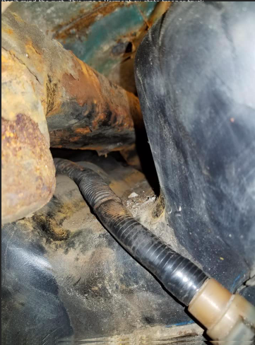

This info is based on my experience with the 2012 Denali....
If the tank has been dropped it's HIGHLY important that the line in the photo be routed over the frame rather than under. Many owners & mechanics have made this mistake. You can put eyes on it be removing the rear wheel on the fill side & taking out the wheel well plastic.
