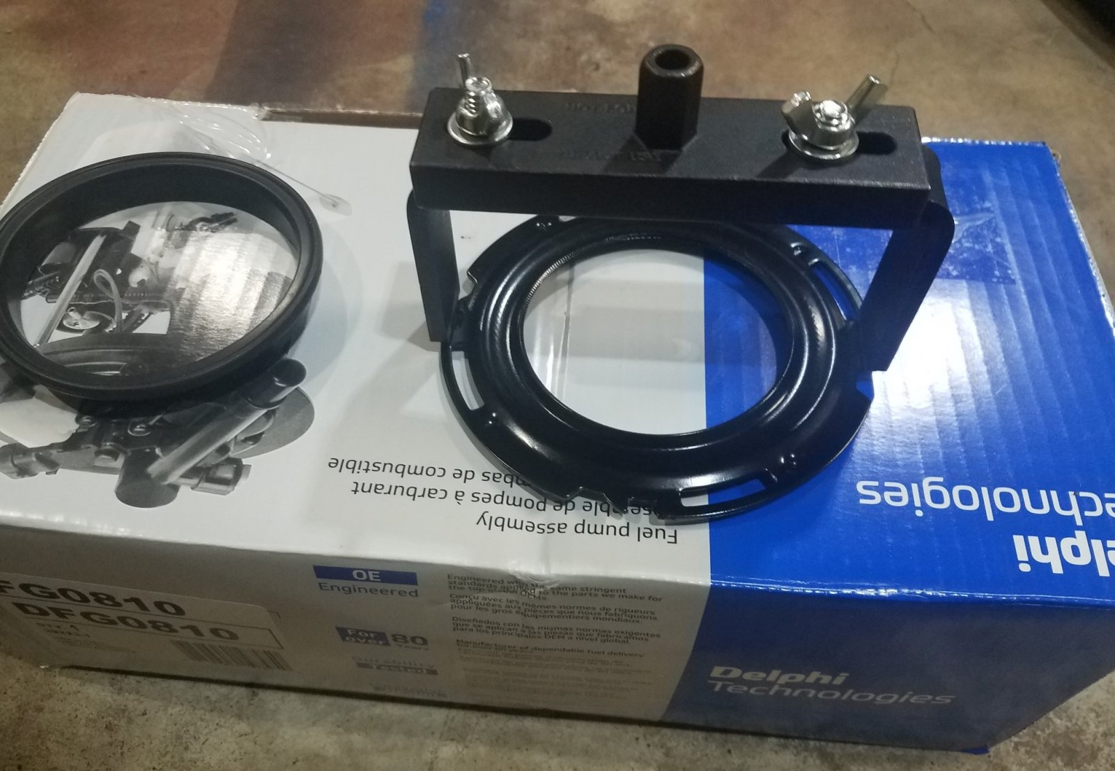

SOLVED. Pump installed and tank back up in place. Wow, much easier dropping the damn thing. Fuel gauge/quantity working perfectly. Filled up. Correct "full" reading then drove for about 50 miles. No issues what so ever. Remained steady with no fluctuations. Didn't mention this in my comments when I replaced the fuel pump almost 2 years ago - but I was having no luck with getting the lock ring off with a screwdriver/punch and hammer - so I purchased a tool. Made removal and install pretty easy.

Thanks for the walk-through and posting the details of the solution.
I had to pull my pump (exactly the same as yours) a couple of years after replacing it, to replace a defective gasket. Not sure if we wrinkled it a little when it went in, or if it was malformed and we didn't notice it. Weird that it didn't cause an evap leak until so long after install.
