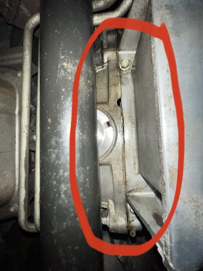

Updates: All fluids changed, have not ran it for 10 min and I look to see oil residue once again where I wiped it clean.
Seems it’s coming from the oil cooler gasket. I saw other threads talking about replacing it and changing the block of plate or something. Dont know if that’s the only place oil is leaking from, process of eliminating. It’s seems to run underneath the oil pan in the crack where it connects to the transmission. Pics below.

Super common leak point. You don't have a block-off, you have the cooler installed. Models without the oil cooler will have a block-off. Each use their own gasket and are not interchangeable. Be sure you order the correct one. At least it's an easy repair! Replace it, hit the whole area again with a cleaner and let it drip dry. Check again after some driving. Be aware that some oil could be "baking out" of the pores in the block and pan and isn't an actual leak. It could weep or wick down and collect on lateral surfaces, appearing as a slight leak. It may take a few heating and cleaning cycles to get all the oil cleaned off, assuming there are no actual leaks.

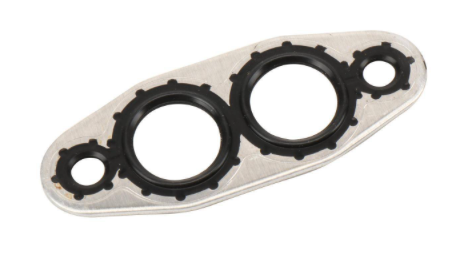

And to add to Chris's post, which is great advice, is to use the OEM style gasket:
...instead of aftermarket designs:
The latter requires too much clamping force to seal. Gotta to be real careful with those bolts because they're small diameter, screwed into aluminum. Stripping one out will ruin your day. Ask me how I know. :(

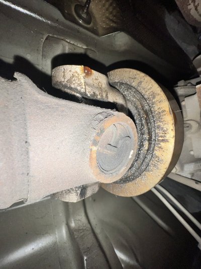

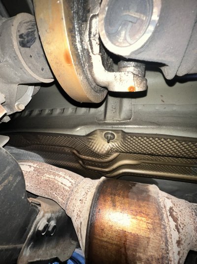

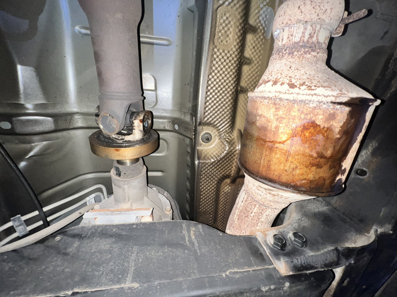

Update: flushed tranny fluid new filter and gasket install. Noticed drive shaft links were covered in oil residue as well and is leaking somewhere somehow. Any pointers on whats causing this and how severe it is. The rubber boot seems dry and fine the u links are caked however.
