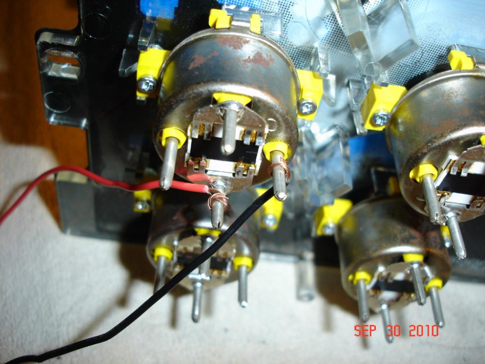

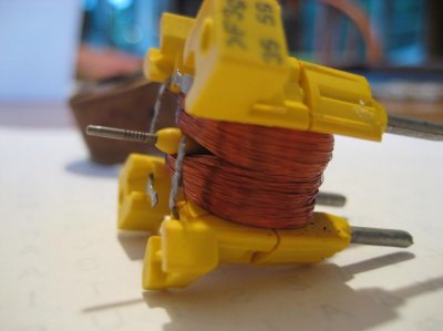

I grabbed a few photos from the thread I posted earlier since they're the same as mine.One of the photos shows a company called Simco. Seems they make gauge motors as well ( I think I see the GM one on the right). The only numbers I see on my motor are inside on the yellow housing(like in photo1)--- >F37
21 50 ..... not sure if they're relevant.
