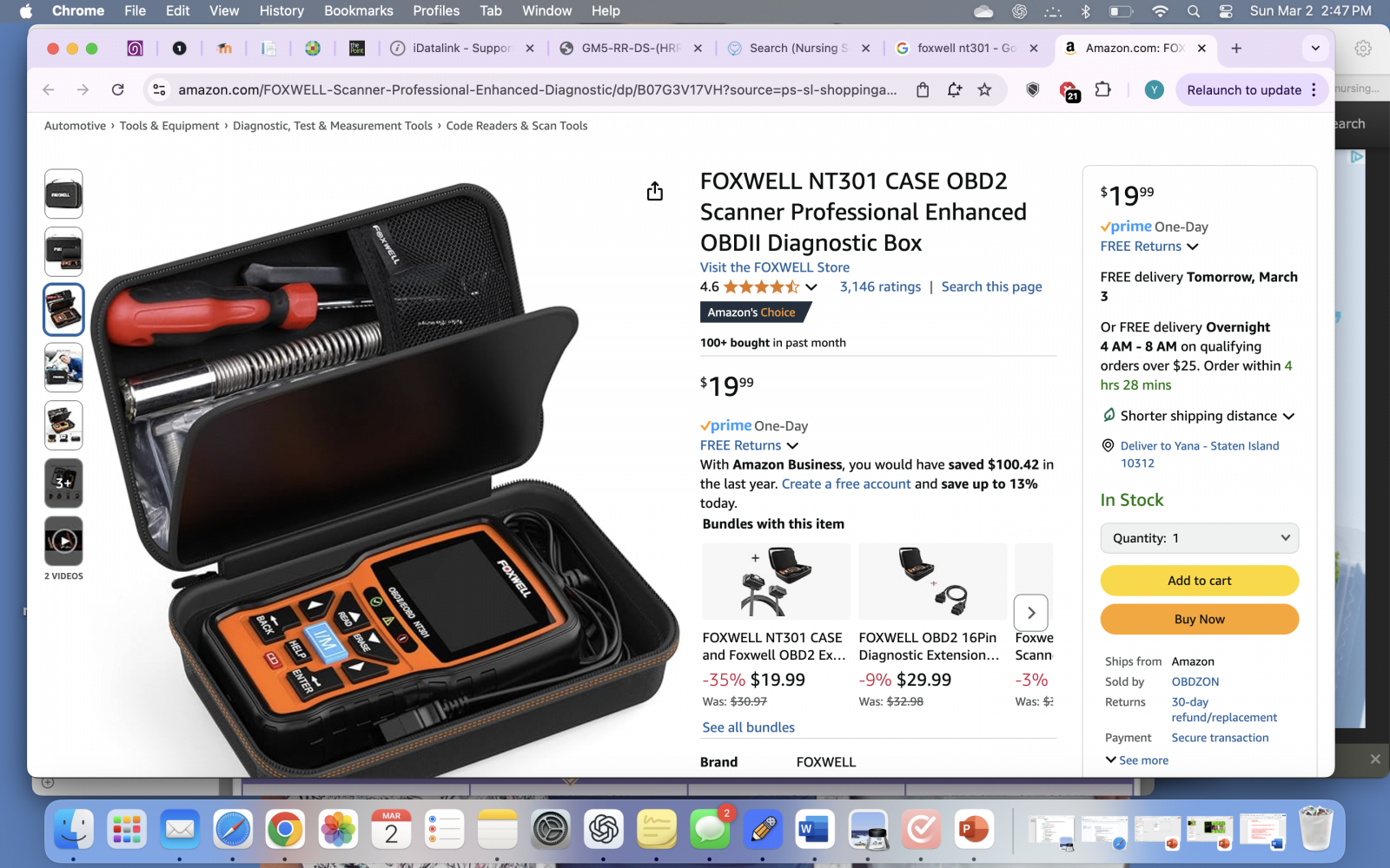

I do use regular. I have a little Bluetooth scanner but I don’t know how accurate it is so I’m gonna grab a decent one. I will definitely keep you updated because this has baffled
