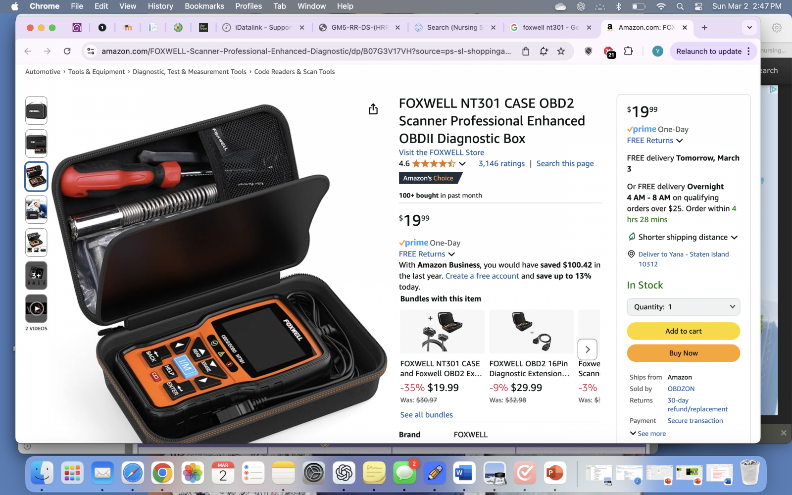

What is stock gears? An inexpensive decent live data scanner would be a Foxwell NT301. Check it out. You also might try a slower burning higher octane fuel, like 89. Also does a better job of cleaning deposits. Might even try some Techron additive. Over the long haul, the cleaner the better and more efficient. If you are lifted and have bigger tires and have a higher gear like 3.42 or higher, you are geared to high, especially with just city driving.
This one?! And I have 3.42 ratio.
