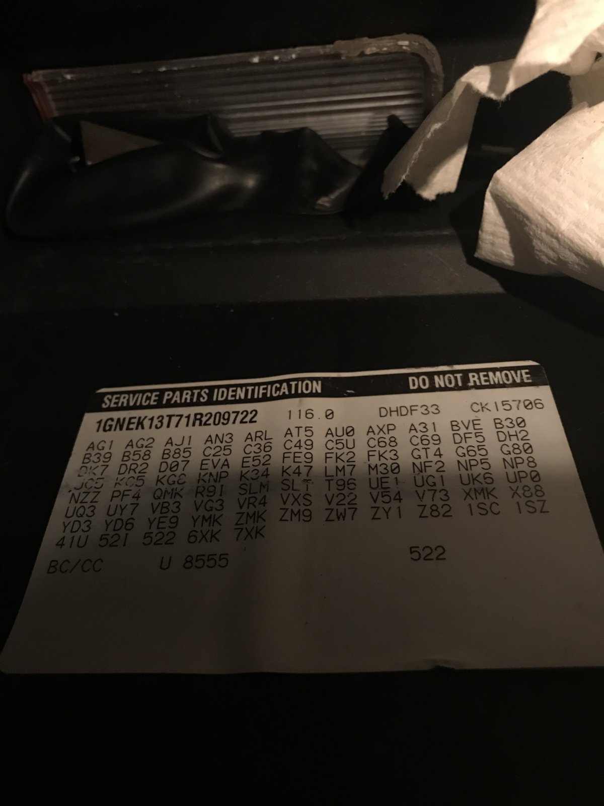

There are at least 3 factory gear ratios available. GU6=3.42, GT4=3.73, GT5=4.10
Also, you didn't answer the question about how you're calculating mileage. As stated, with an oversize tire, unless you reprogram for that tire size you are physically travelling more miles than your odometer indicates (you're also travelling faster than your speedometer indicates). Therefore, you need to adjust your mileage numbers with hand-calcs, use a gps to track miles-travelled, or have it reprogrammed for that tire size. Until it's reprogrammed the DIC information is completely useless without doing some maths. You should be able to find info on revolutions/mile on the stock tires vs your oversize tires and scale the numbers.
FWIW, stock size tires, 5.3L 4X4, 4.10 gears I get right around 16 mpg
Alright I run the truck completely empty then fill up. Then I run empty get totals miles ran divided buy how many gallons used.
And as for gear I believe it 373

Do you know what ratio? It should be on the RPO code sticker on the dash. Also you can create an account with GM and they will send you a build sheet that shows all the options your vehicle has based on the VIN.
I have an account with GM, was curious where to look on the site? I couldn't find anything regarding build sheets.
