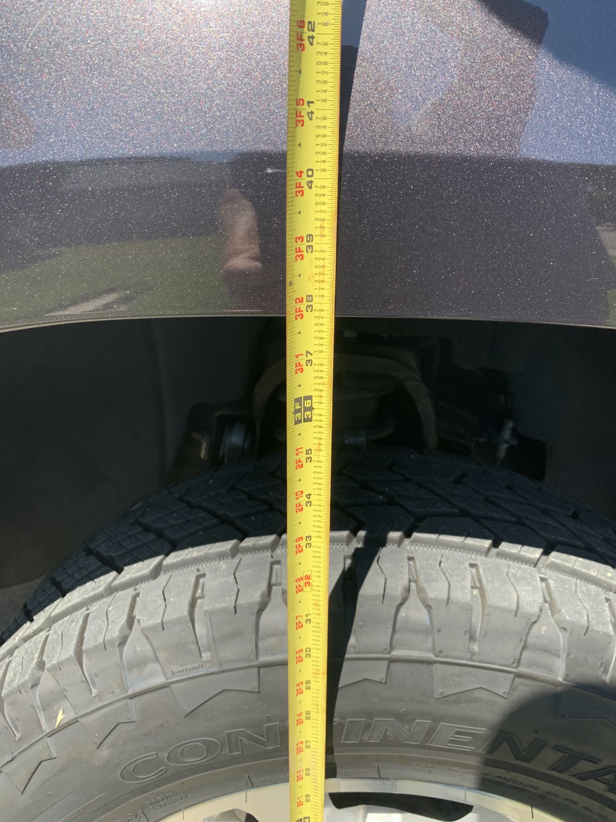

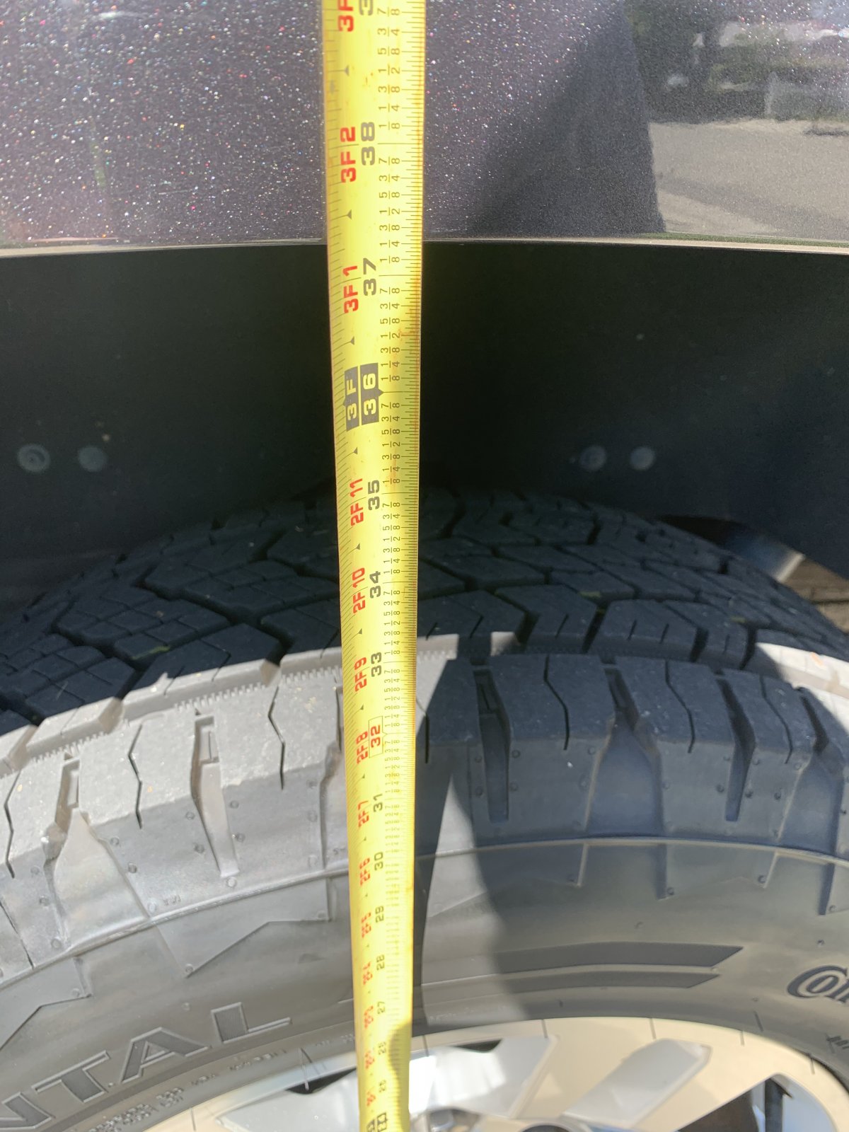

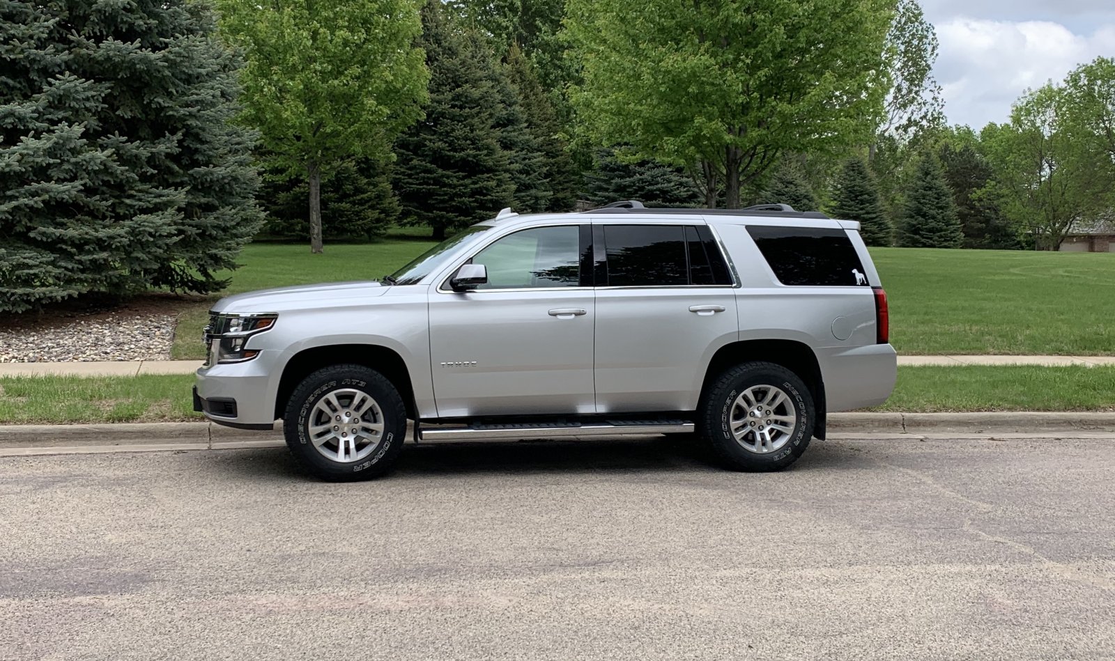

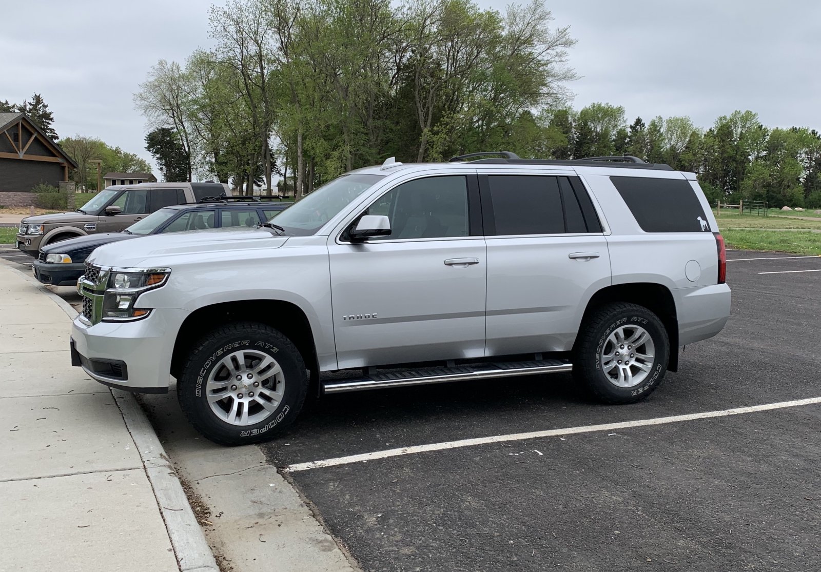

275/65 r18s here.
On the first picture the 5100s are set to the highest position (4 out of 4), the tops of the front and the rear wheel wells are at 38 inches. The highway handling was slightly off compared to the stock.
On the second picture the 5100s are set to the 2 out of 4 position, the front sits at 36.5 inches. I would chose this configuration if you are regularly driving over 65.
P.S. The rear is stock and has the max tow air ride shocks.

275/65 r18s here.
View attachment 250924 View attachment 250925
Damn good lookin truck! The second pic sits really nice. I recently picked up a set of those same rims you guys have - found some take-offs on CL.
