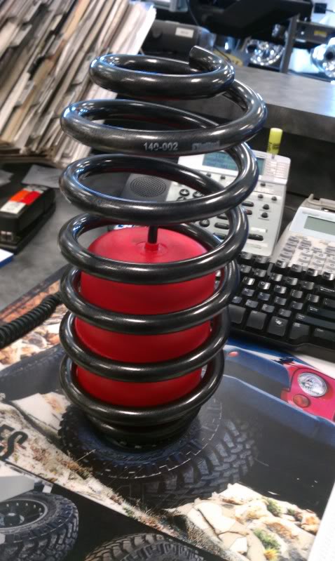

I have the other bags, just ordered the oe trailblazer bags to see how they fit. I'm not cutting the coils, just seeing how low it'll sit with just the coils...I can always cut them later if need be. I'm gonna try this setup with the bilsteins and see how it rides, I have the belltechs in stock along with some 9000XL ranchos and plan to try a few others. I've done the ranchos on a few other lifted tahoes and they rode awesome.

with the belltech rear spring and street performance shocks rides great. the bag in my pic fits in no problem and dont even waste your time on that bag use the 6 inch extended one.

I may cut them, just apprehensive about cutting coils from my import days. The ranchos look burly as hell so I may go that route simply for the adjustment and overall size. I found some that are 21.5" extended just like my bilsteins...remember I have shock extensions.

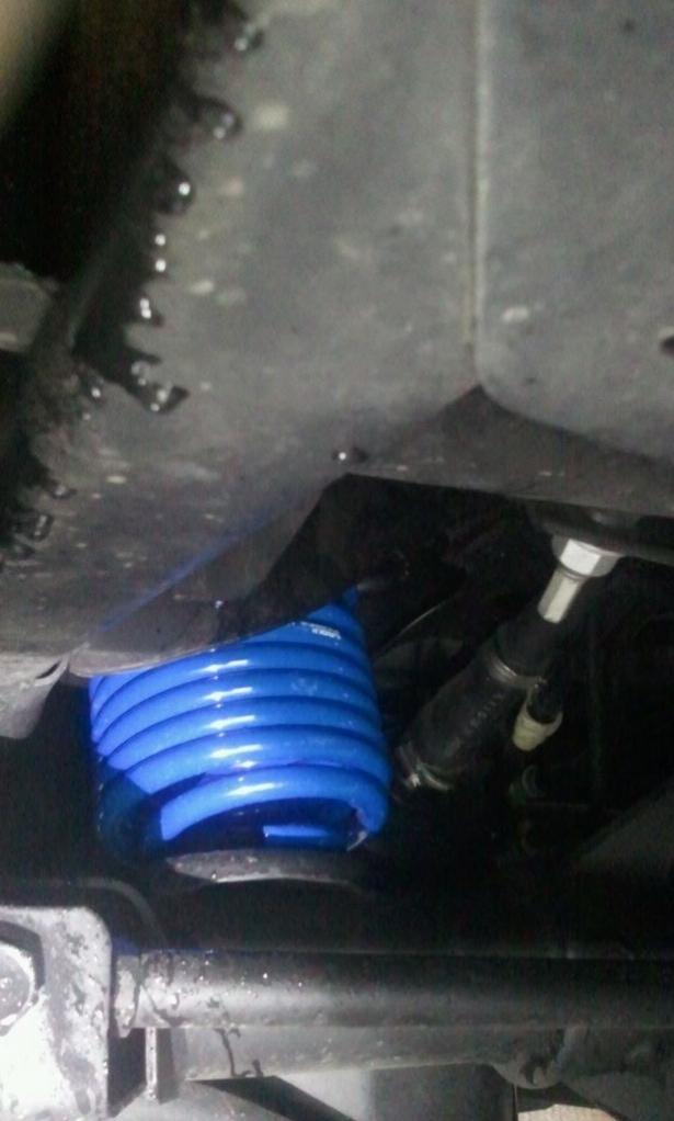

if you cut the springs will sit low.
also you want a good riding spring ive been testing the gf tb spring and with its dead coils it has ive cut them and ride great.
here is a pic of it installed this same spring gave a customers tahoe a 4.75 drop off the batt. thing is with 7 dead coils you can trim WITH NO change in ride just height.
check out this thread
http://www.tbssowners.com/forums/showthread.php?t=59895
