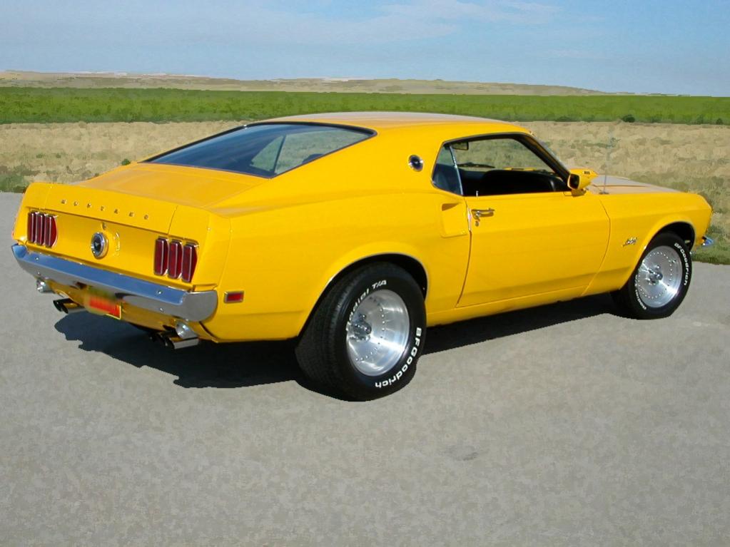

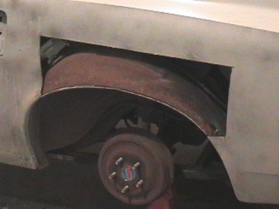

Yep, not too bad of a project, really... :Handshake: The paint on my '69 Fastback is 7 years old...and it looks as good today as it did 7 years ago. :) It took a TON of cutting/patching/pulling/pushing/cussing/bleeding/sweating/sanding/welding to get it to look all purdy. It was a total nutcase when I got it...rust EVERYWHERE. And seven years later--still no rust!
