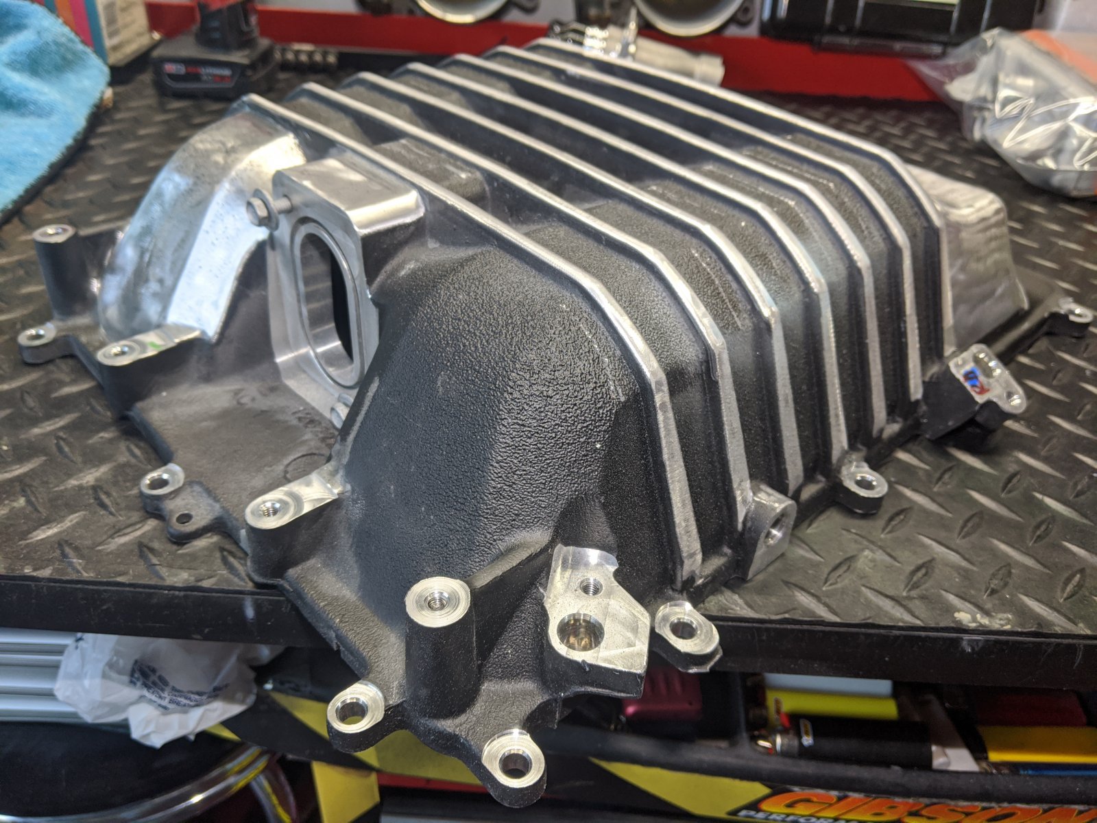

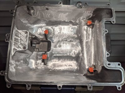

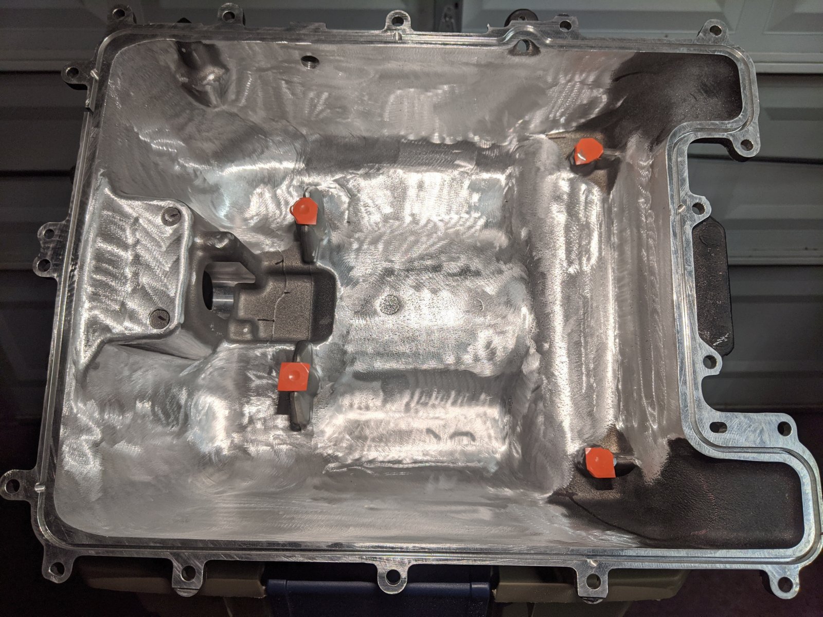

Project name "Undercover Sleeper"
What I have done, so far (as of 11 MAR 2020)
- Ported LS7 Throttle body (ported by Me)
- Ported OEM intake manifold w/intake manifold gaskets & injector O-Rings
