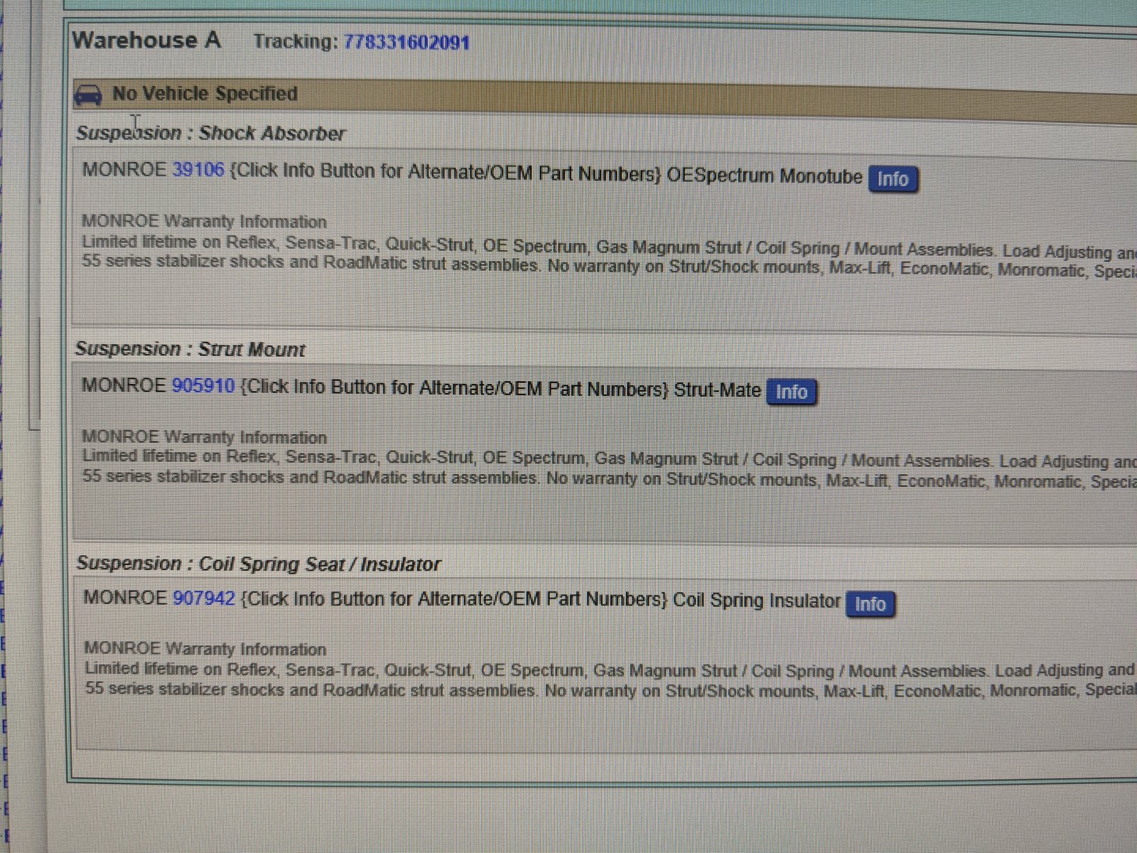

Ordered new OEM PPV shocks/struts, top hats and isolators & bushings...... RockAuto FTW

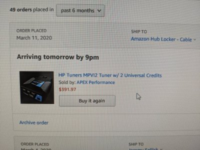

Ordered a HyperTech Max 2.0 #2000 as well; merely so I can reflash for my gear swap, turn off the AFM, torque management reduction and use the 93 octane (BUT: I will be running E85 = 108 octane)

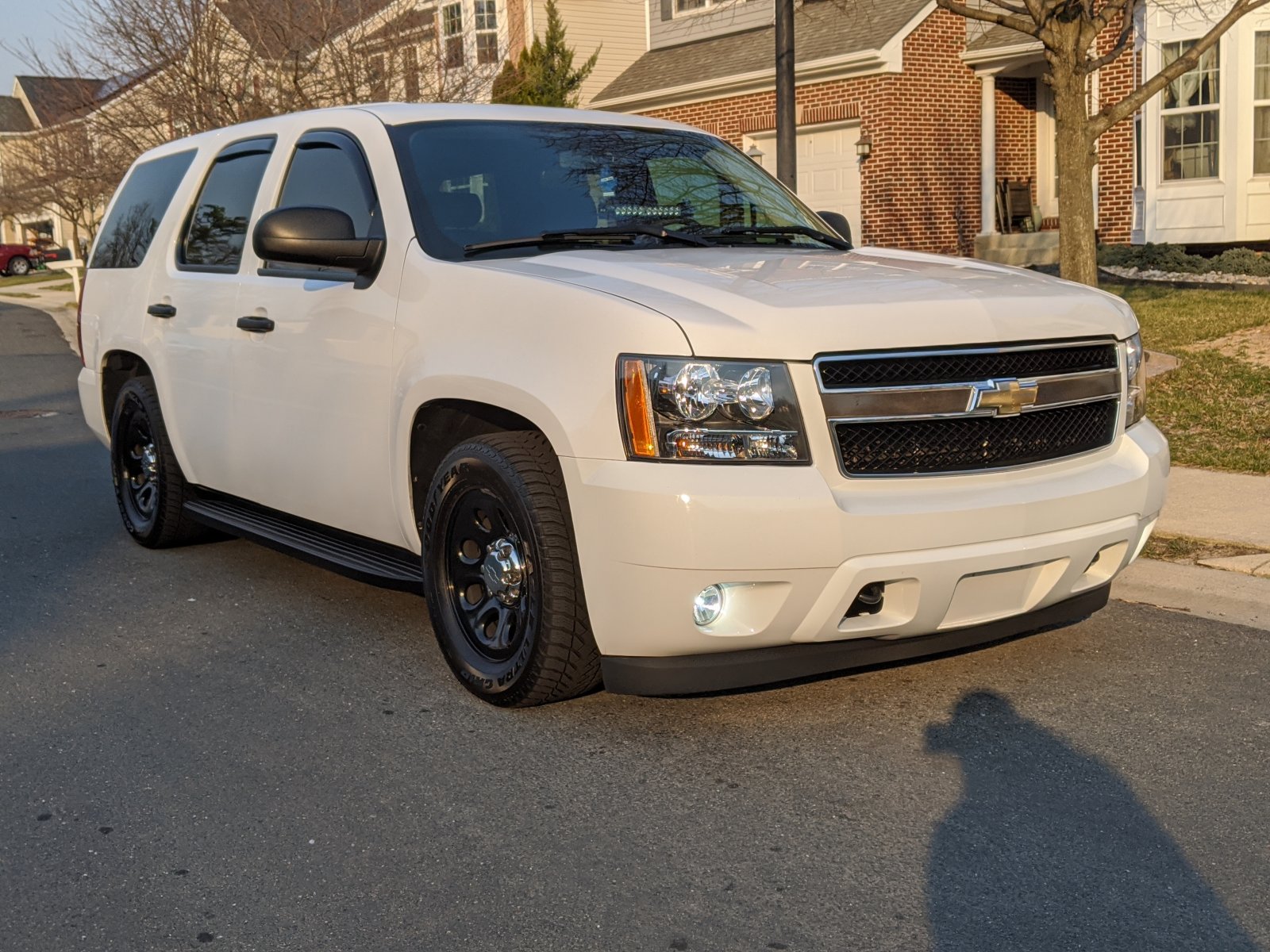

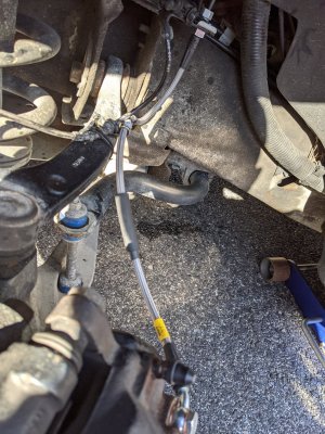

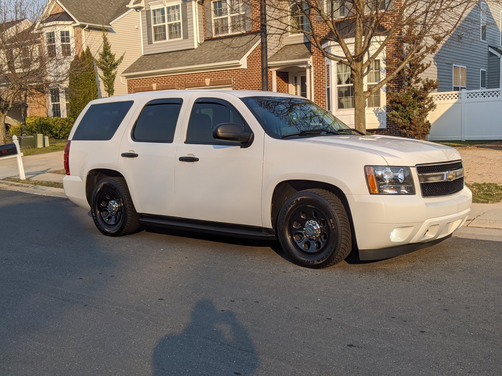

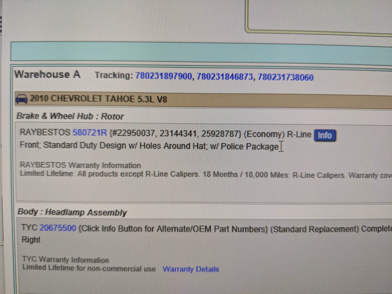

Some stuff I'm working on or ordered.
The timer was my 0-60 on a 87 tune...... haven't had a chance to time it with the E85 tune yet
