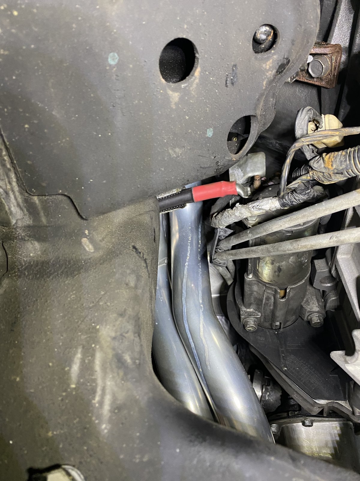

The Denso radiator I installed a few months ago had the built-in engine oil cooler, so I bought the OE oil cooler line set. I don't think I need an EOC, but the rad had the thicker core I wanted. Between the rad and EOC line set, the rad was still about the same price (or cheaper?) than the non-EOC OE rad. I installed the line set while I had the oil drained:

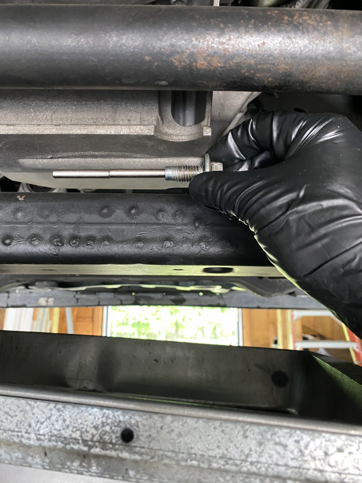

My oil pan is Helicoiled and the plug has been replaced. Apparently, the stock plug should have a magnet. I wanted a magnetic one, but I didn't know if the thread was the stock size or if it had been changed. So, I decided I'd just make my existing plug magnetic, but extra. Got these two neodymium (N45 for you nerds) rod magnets, 1/4" D x 1.5" L off ebay. I was gonna use one magnet, but they were sold as a pair and the other one stuck to it so well that I saw no reason to not use it:
This is how far they'll reach into the pan, minus however much I set one into the plug:
Before I pressed a magnet into the plug, I stuck them to the tip and inserted them into the oil pan and moved them around a few times to grab as much metal sludge as possible. This may be an unnerving sight to some people. But, considering this is the first full-term oil change since having the engine apart and installing all those new parts almost a year ago, I'm not the least bit concerned... yet:
Used the drill press to drill a 1/4" hole about 1/2" deep down the center of the plug. Not bad for eyeballing center:
I thought I was gonna have to epoxy the magnet in place, but it was a firm press-fit, so it's not going anywhere. I ended up with right at a 65mm (2.56") strong magnetic tip:
I held one magnet and slung it a few good times, trying to fling the other one off. Best I could do was make it flip around and stick parallel to the other. So I don't see that "unsecured" one going anywhere. It'll be about a year before we find out what it catches. By then, I'll probably forget it has magnets and be surprised when I pull it out.

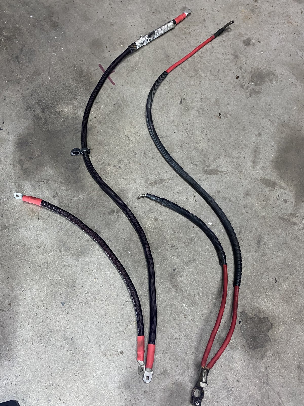

And, finally, I finished the Big 3 Upgrade since my battery terminals were delivered:
Cut the factory battery terminals off the factory ground wires and soldered, crimped and heat-shrinked lugs to them:
Copied the factory positive cables with the 1/0:
Also made one for the starter:
Done. Yes, I could've use elbow lugs for the ones going at an angle, but it doesn't bother me enough to buy $15 specialty lugs.

Damn! Very nice! Excellent work! Need to do this...

Chris,
did you wrap them electrical wires or did you buy em that way? Nice touch, before I drop the engine in I need to do this. Pls hook me up with the lug part numbers, etc., so I can get a move on when I get back stateside?
