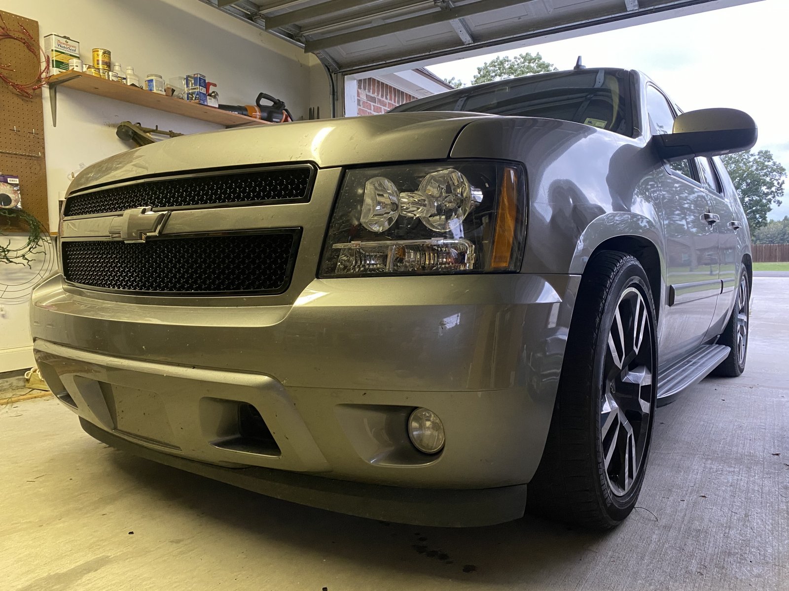

I like this look and drop with maybe a little shorter tire.
Thank you. I'm satisfied with it. I let the whole drop amount discrepancy go. It rubs badly enough as it is so 1/2"-3/4" more drop would just be that much more clearancing needed. Considering the lucky fluke of results from the experimental rear coils, I should be satisfied with the stance.
If I were to do shorter tires, it'd be on the 22s. But they ride stiff enough as it is.
