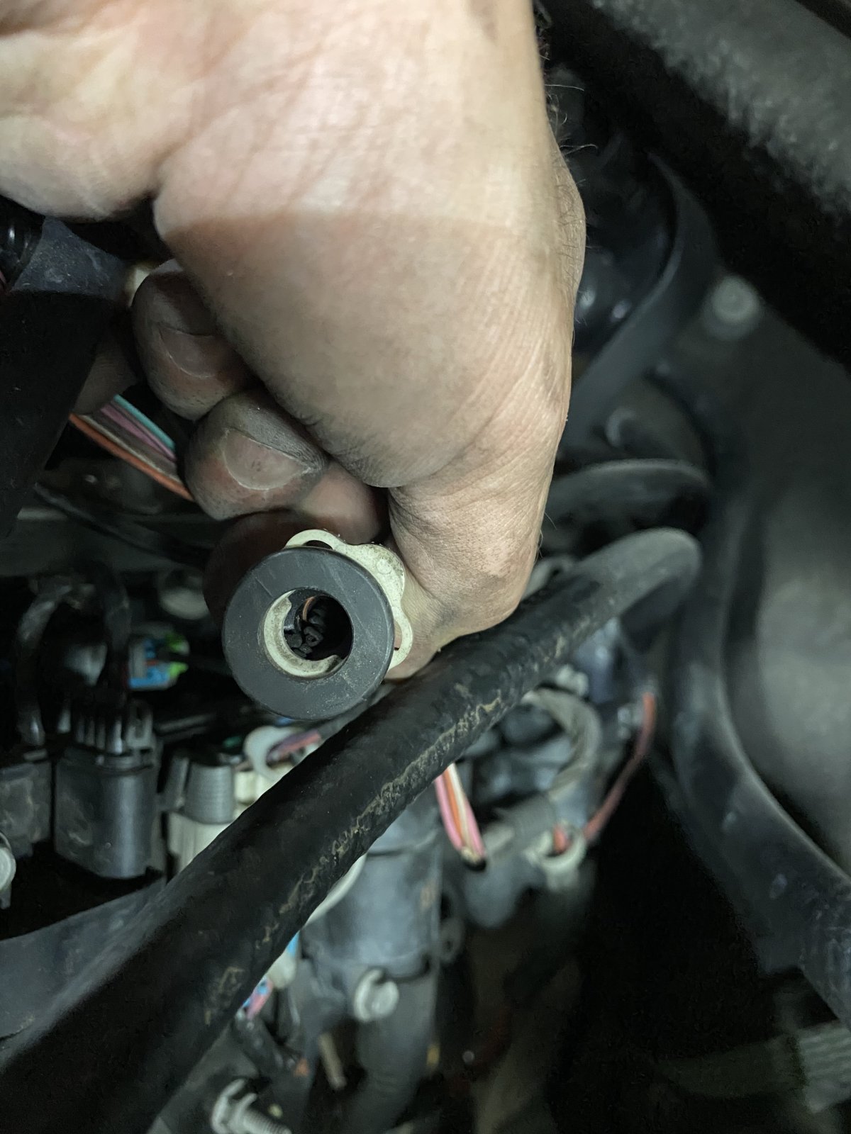

Anyway, after looking up the specs on the other recommended shock, the 2410FF, I found them to be identical to the Bilstein I had on hand. Time to get busy! The Bilstein had a bar pin mount for the top and regular bushing for the bottom. I pressed the sleeved bushings out of the factory shocks and cut the sleeves out of them (burnt rubber particles everywhere). It sounds like it was so easy and quick just typing it out, but it sucked and took a couple hours last night and this morning. This even included me having to cut a 7/8" impact socket in half to retrieve the bushing sleeve that was stuck in it.
As much as all of this sucked, I did figure out a cool way to bore out a rubber bushing's ID cleanly and while maintaining it's center. Use a paddle bit of the desired size and slide the stem through the bushing, then chuck it up in the drill. The tapered backside of the bit keeps it centered and it'll gradually and cleanly open up the hole. A regular bit would've dug into the bushing and chewed it up and likely wouldn't drill straight:

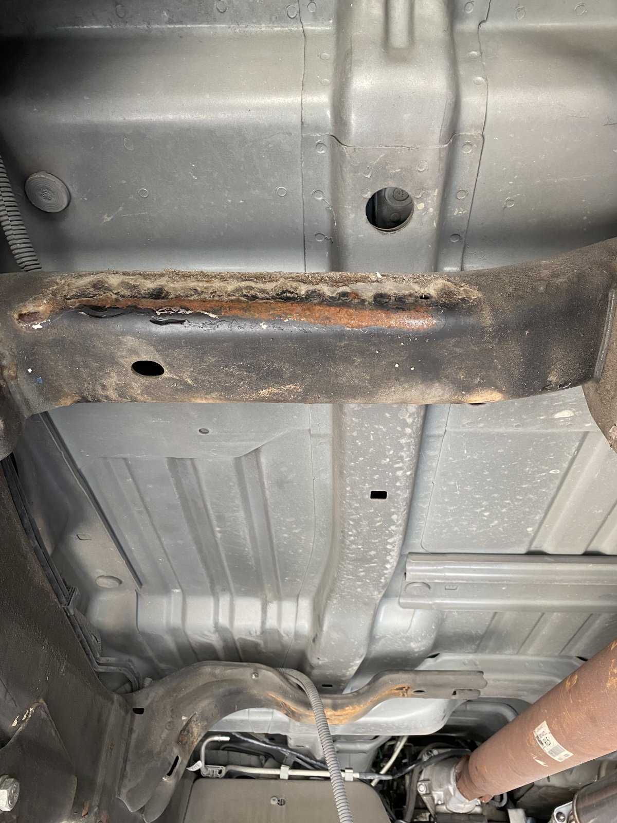

After boring out the rubber bushings, I was able to press in the factory sleeves and bolt in the shocks. While I was under there, I saw where my sway bar had been rubbing the shock mount due to me not having the axle centered, so I clearanced it a little and adjusted the panhard.
Before:
After:
Yes, I smoothed and painted it after I was done. I also flipped the axle side half of the panhard to put the grease fitting facing downward. Cutting that ear off for more clearance a week or two ago exposed the fitting as the new high point, which means it'd get snapped off should that part ever bottom out against the cross member. The mount has a slotted hole in the underside so the fitting is accessible from the bottom. Simple solution there.
