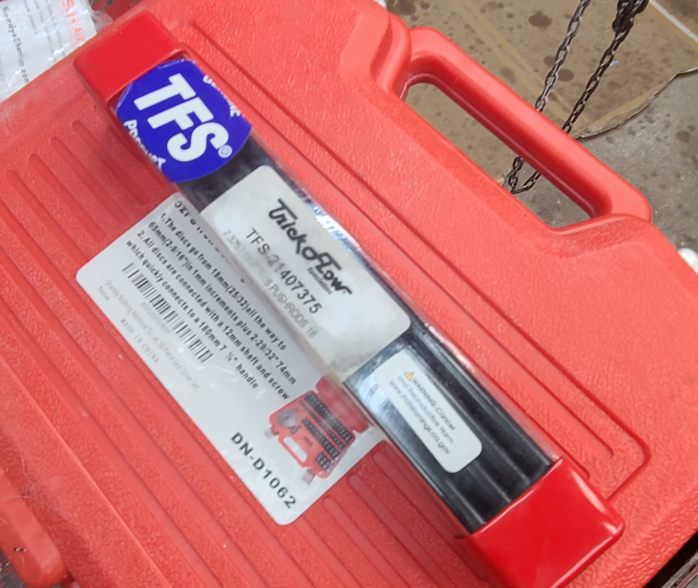

Had 16 big black rods waiting for me on my doorstep last night:
Had to test fit one. Should be enough clearance. After all, the point of 3/8" pushrods is to reduce/eliminate flexing:
