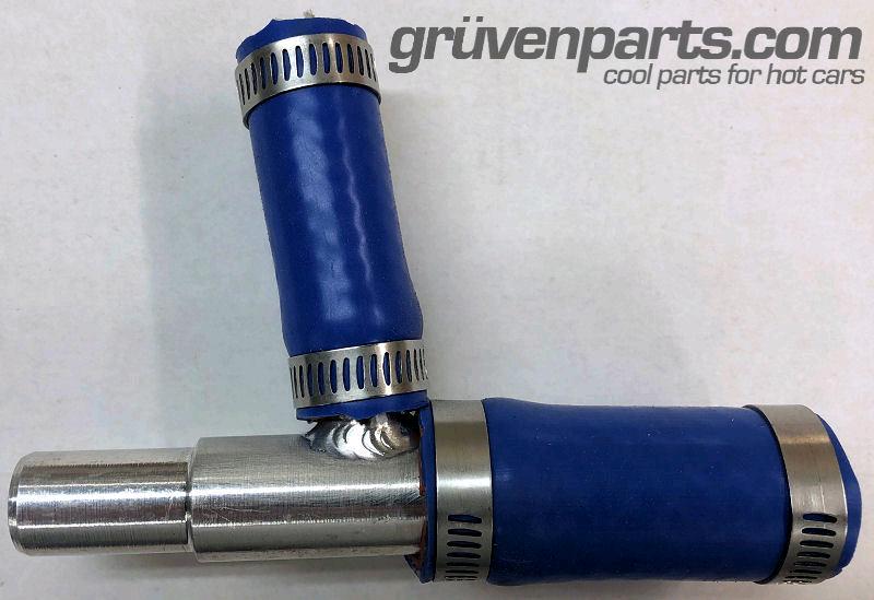

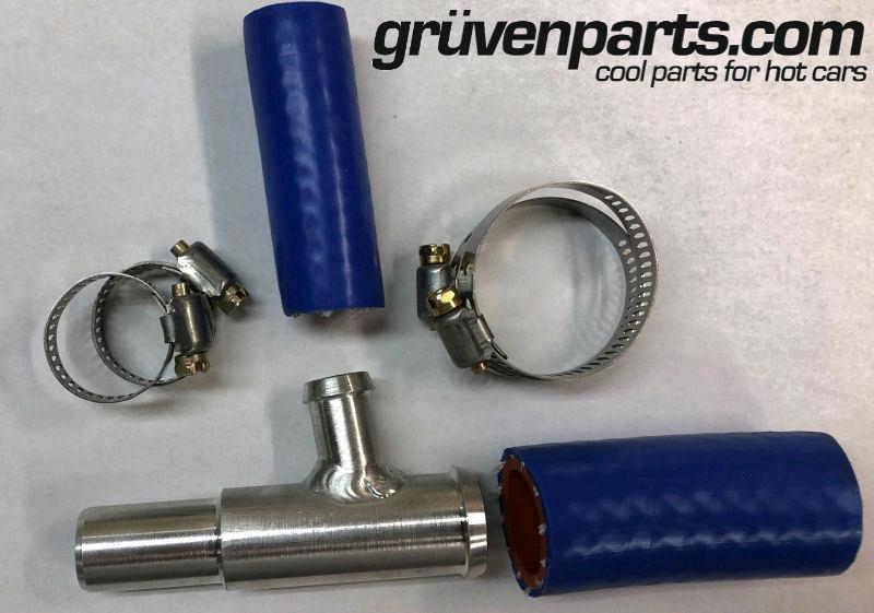

Looked at that improved heater core T-connector, brought my attention to the rubber hose connection issue.
How does the "T" connect to front and rear heater Aluminum tubings, which have NO barbs; also the "T" connect has NO barb on its end toward hose from engine.
None of them have barbs per say but they do have a rib on the end of the aluminum tubing that the plastic piece in the QD clips over.
The new T-connectors will come with short pieces of silicone hose to go between the fittings and the tubing and clamps.
