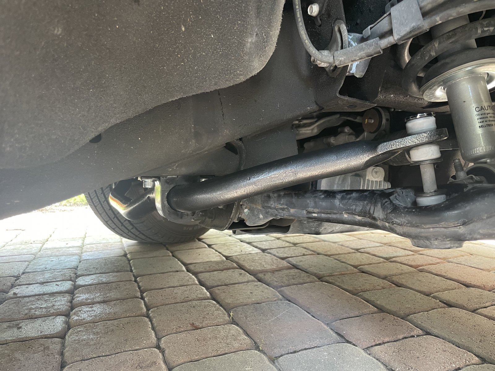

Oh man. After seeing this post, I looked at my install and the bar was turnt up. Even with a small level kit the links need to be modified. Cutting one spacer in half (duralast golds) was the solution - that small difference is remarkable in making almost zero body roll. I like my burbans like I like my women...

So I need to shorten the spacer and use the 4” bolt instead. I’m still a bit too high.
