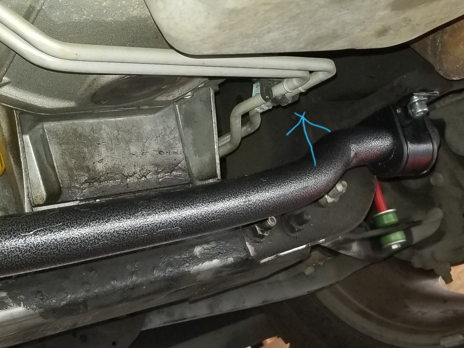

You won't be disappointed. I just installed mine and they make a HUGE difference. The front bar is HEAVY, so you may need a jack or a second set of hands to lift and hold it in place, until you have secured the 2 U-brackets.

I was just looking at the installation instructions and it said that if you have a 6 speed tranny that you will need Spacer Kit 7799 to provide clearance for the tran cooling lines. Did you run into that issue Thanks
