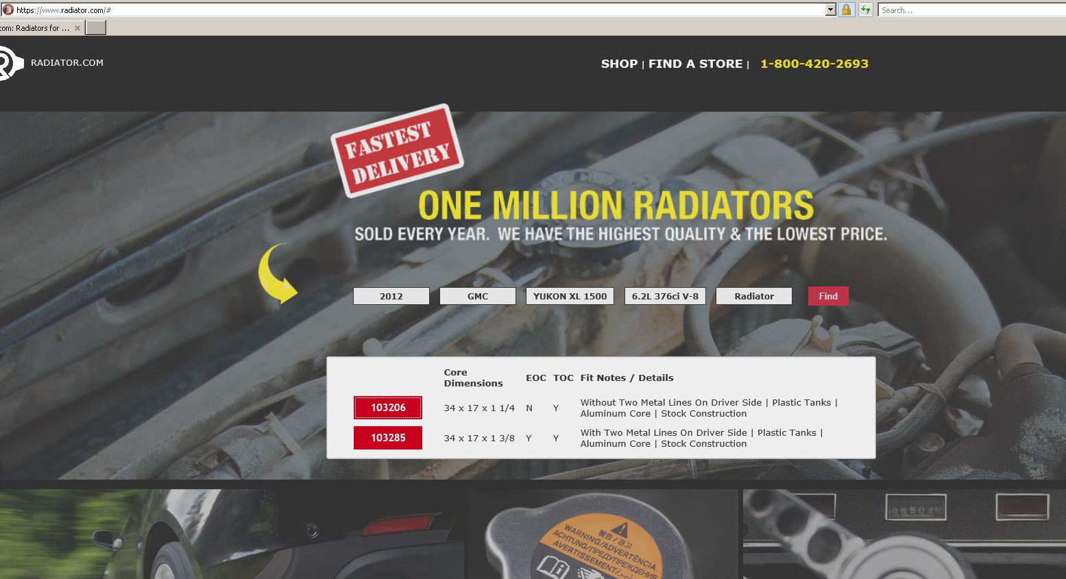

there is the 103285 from 1800radiator, lifetime warranty. not sure what the price is at the moment, but they are located all over.
I was just going to post this.
This part number has both coolant and oil cooler included and was a direct replacement.
Fit like a glove and their service was actually very good. I had an issue with the first one and they had a new one out the next day no questions.
