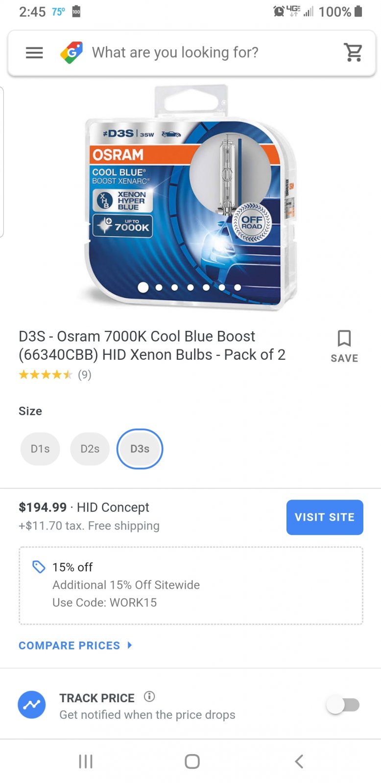

I got these..... if I can get them in smh

I was just going by the description - "7000K cool blue". I've had good experience with both Osram and Philips but I always saw a hint of blue at 5000 and above.
CMoore711
Jul 18, 2017
1,401
1,260
All the videos and reviews of the OSRAM CBB are closer to 5500-6000K max. The type of projector can affect light output, intensity, and cut-off as well.
I have a feeling the OEM projectors in our GM SUV’s aren’t considered “top performers” in the HID projector game.
