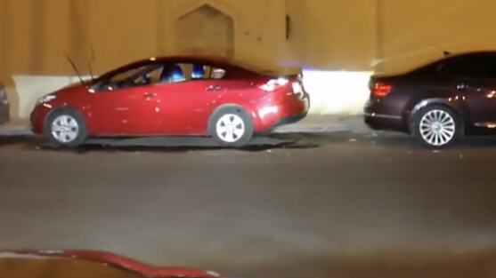

OK sure, check this video.

Thanks fo the link, very informative video of what our headlights look like inside once opened up and the projector mounting position.
I'm not sure if that video is for just a lens upgrade... While driving around the driver keeps activating the high beams and if you look at the beam pattern on the building @ 2:56 it looks exactly like the beam pattern of a bi-xenon projector with the high beam activated rather than separate high beam bulbs. Which would require a completely different projector than a stock GM SUV projector. I could be wrong...
