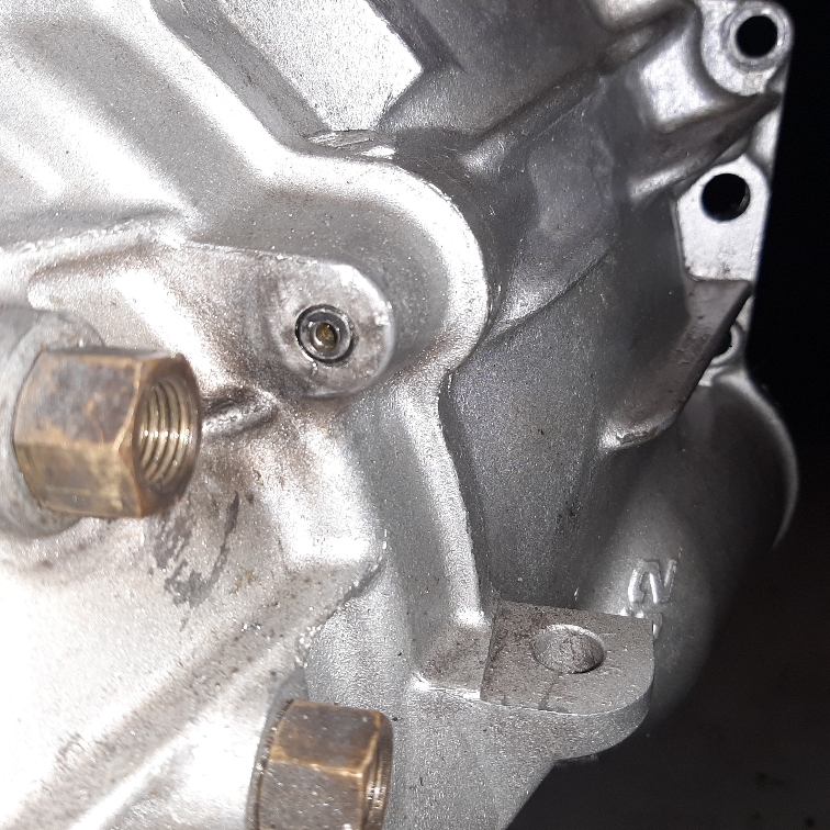

Just a mild build on a 4l60e all stock everything except jet billet 1-2 and 3-4 servos and cover. Transgo hd2 kit with the "street strip" selection for the separator plate holes and accumulator springs.
Vortec 4300 in a 96 s-blazer with minor work to it. Nothing special, literally dynoed like 170/230 to the wheels. Was real spunky for having a 3.42 gear.
The problem was when the heavy swampers went on and they gripped the mud pit a whole world better than the all terrains. Violent bang and all neutrals. And it gets better. The engine wouldn't start after I shut it off...1210092032a.jpg 1210092032a.jpg took the center out of the flexplate at the same time.
