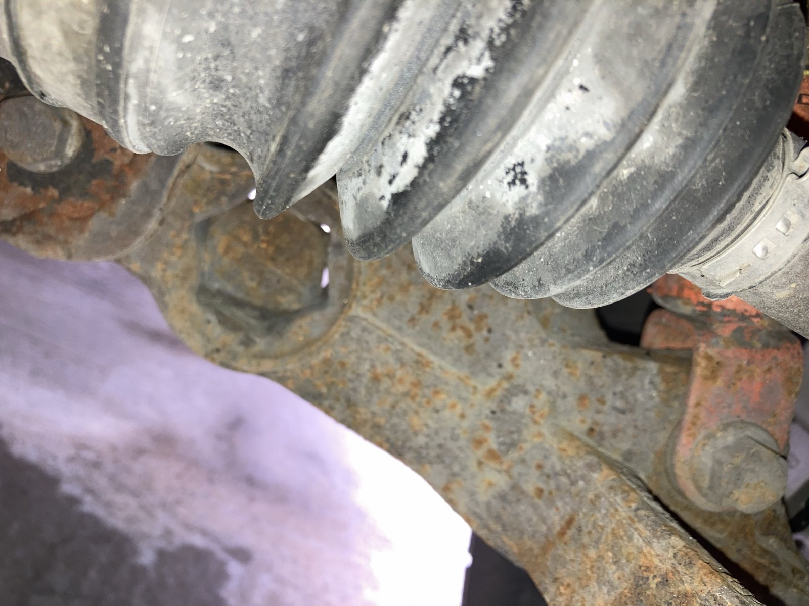

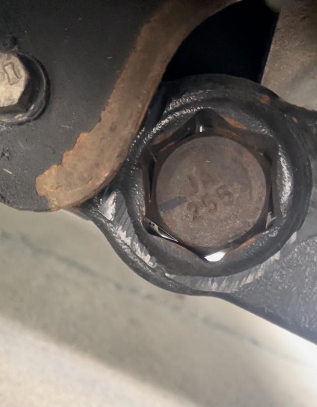

Hey guys, quick update. I haven’t greased the sway bar mounts yet however I did unbolt the end links just to see how the susp would react to no sway bar at all. The harsh ride and clunk when taking off reduced however did not go away. I’ll be greasing up the mounts later and reattaching the links but I did notice something. The torsion bar fitting/knuckle in the LCAs seem unusually large. Picture fitting a 17mm socket on a 16mm head bolt. Is that normal for everyone or are the LCAs that they sent me not correct?

Was the clunk there before lowering? And I see u said u changed the Lca. Did u just do the ball joint or the whole arm? Also mine is a 04 tahoe with 3/6 drop. I had the same issue. Loud clunk. Sounded like it was from the middle or front somewhere. I finally found what mine was. When I put my drop spindles on (mcgaughys) I messed up my driver side lower ball joint. So replaced it. It was a pain to press new one in. So with having new ball joint on that side I wanted the other side new. Didn’t want to do the press thing again so I changed the whole lower arm with ball joint already installed. So after installing I started getting that loud clunk. I ended up replacing my whole front suspension just cuz I wanted it all new. Not cuz the clunk. I went with moog on everything except upper a arms. They are ac delco. Well when I messed that ball joint up I had got a cheap one put in it. I didn’t like that as they have a lot of load. So I ordered 2 ac delco ones. Pressed into my arm an then the other side that I had changed the whole arm I ended up pressing that new ball joint in my oem control arm an putting it back on an not using the new one I had installed. Clunk was gone. I think where the torsion bar went into the after market arm it had slop in it or something an it was the torsion bar clunking. Hasn’t done it since

I think the after market arm hex slot that the torsion bar goes in was slightly bigger. It made it pop an make all kinds of sounds when braking or taking off.

I found a TSB on body mount insulators so I’ll be replacing those as soon as those come in. I’ll also be re-indexing the torsion bars as I noticed they are rotated counter-clockwise by one hex. If either of these don’t work I’ll be replacing the LCAs as a last resort. I appreciate your feedback, it gives me a little hope for my suspicions on the hex opening.
