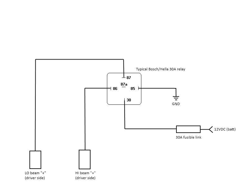

does anyone know if its possible to do a 6 low mod? if so, how does the wiring go for the diodes?

easiest and cheapest mod ever! did it today and it worked just fine. got the diodes from radio shack for like 1.50. thanks!

ok, sorry but maybe i missed something. Why can't the 4 high or 6 high with the diodes be done on a '02? Something different in the fuse panel?
I'm not sure it COULDN'T be done, just that it's even easier to ground the yellow wire. Saves you a buck or two on diodes, too.
Mine's an '03, so I don't know for sure, though.

ok, just looked at my '02 and it doesn't seem to have a seperate relay in the fuse box for the low and high been. the only one i see was labeled "HDLP" so might have to go the cheap route of grounding the yellow wire.

i have don that under the dash but i really won those day time drining lights in the middle on too pleas let me know if it can be done thanks
