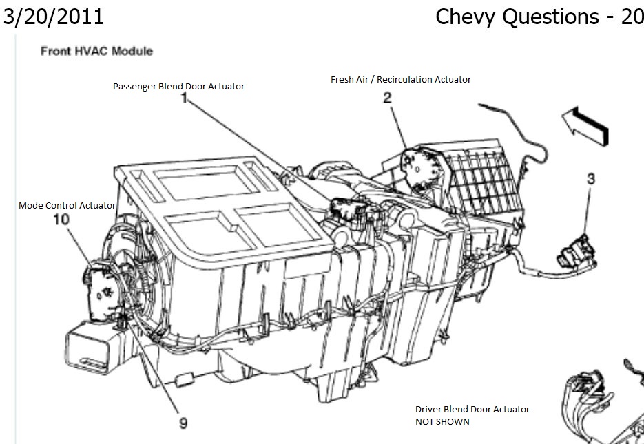

I believe it's the actuator that is behind the radio, or possibly right under drivers dash. think that's the one that controls the air from left and right in front. someone else might know exactly, but I believe it's that one. Best way to figure it out, is get in there, move the door manually to see if it fixes the problem.

the blend door actuator behind the radio does the passenger side.. driver side is above the hump...
I had the drivers side hot last summer,, took the actuator out, and apart and cleaned.. works like a champ..
the passenger side now is being dumb, and it's the bastard part behind the radio...

Is that one considered the "main" actuator, or the "auxiliary" actuator? Mine is bad also but the parts store lists two, one's around $40 and the other is around $140.
