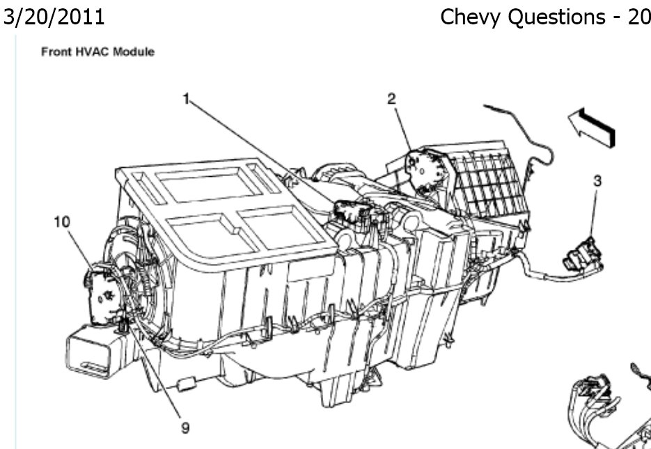

the blend door act for the other side is behind the radio! That was the easy one to get to.. There is also one on the drivers side above the hump that controls the air location(defrost,floor,vent, ect)..
Word of advice.. The back bolt in the long panel that he removed to get to the blend door act,,the aggervating one over the hump,,, throw it away.. the other fasteners will hold everything just fine, and you'll never deal with that aggervating bastard-bolt again!

Bfranklin74- yours sounds like the actuator behind the dash, cause your atleast blowing cold from one side, but not the other. And pretty sure that actuator behind radio controls left and right/driver/passenger, air. But didn't need to mess with that personally
