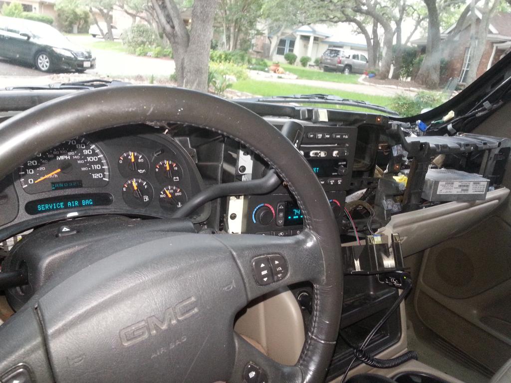

So I've narrowed it down to both the L&R and recirc actuators (See attached #1 and #2) HVAC.jpg My question:are these actually doable without removing the whole HVAC Module? I started to dig into it and it doesn't look like much fun....
