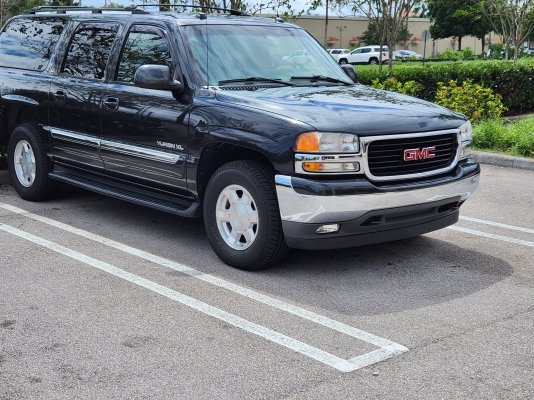

The Hellwig bars fit easily front & rear on my stock '05 Yukon XL... Are you saying, the bars don't fit as well if your truck is raised or lowered?
The control arms are all in the same place with drop knuckles so that has nothing to do with it. The biggest issue I had with all three of them I’ve installed were the bushing brackets not lining up with the holes and had to be bent to line up. New sway bar links were a bugger to get started as well but the one I reused them, it wasn’t an issue. None of that is a deal breaker.
I’m just saying that everything isn’t necessarily perfect whether it’s OEM or aftermarket. The Hellwig bars aren’t perfect but that’s ok but a little tire rub is an issue even though that sometimes happens at stock height too with non-factory tires. The Michelins are more squared than the Bridgestones and rub on many trucks but they’re a far superior tire, so again that’s worth it. I’m pretty sure the 22” Bridgestones don’t rub with my drop but they’re garbage tires, definitely not something I’d go back OEM with.

Yea... I noticed a little mark on the L/H frame- bushing bracket, from a "tap-tap".... Just a little massage to fit...
Just like home construction.... nothing is actually square.... You have to make it fit.
