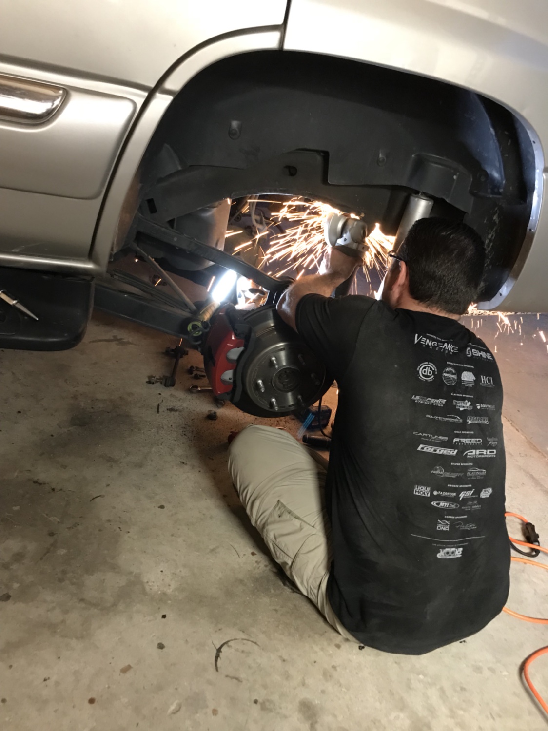

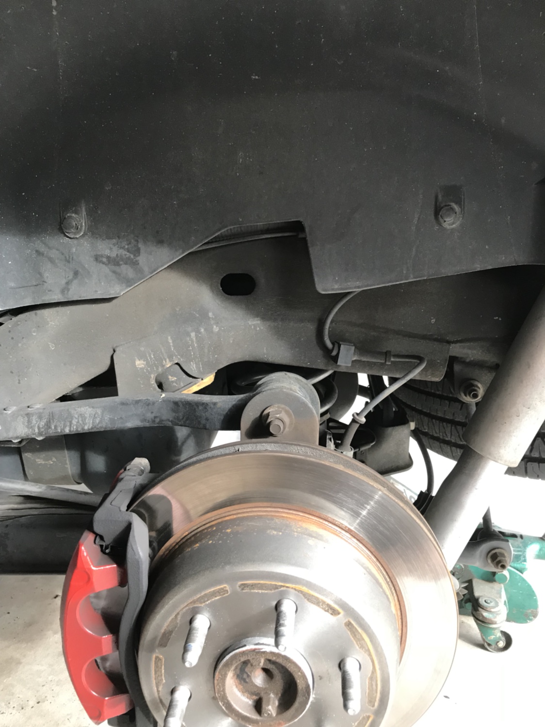

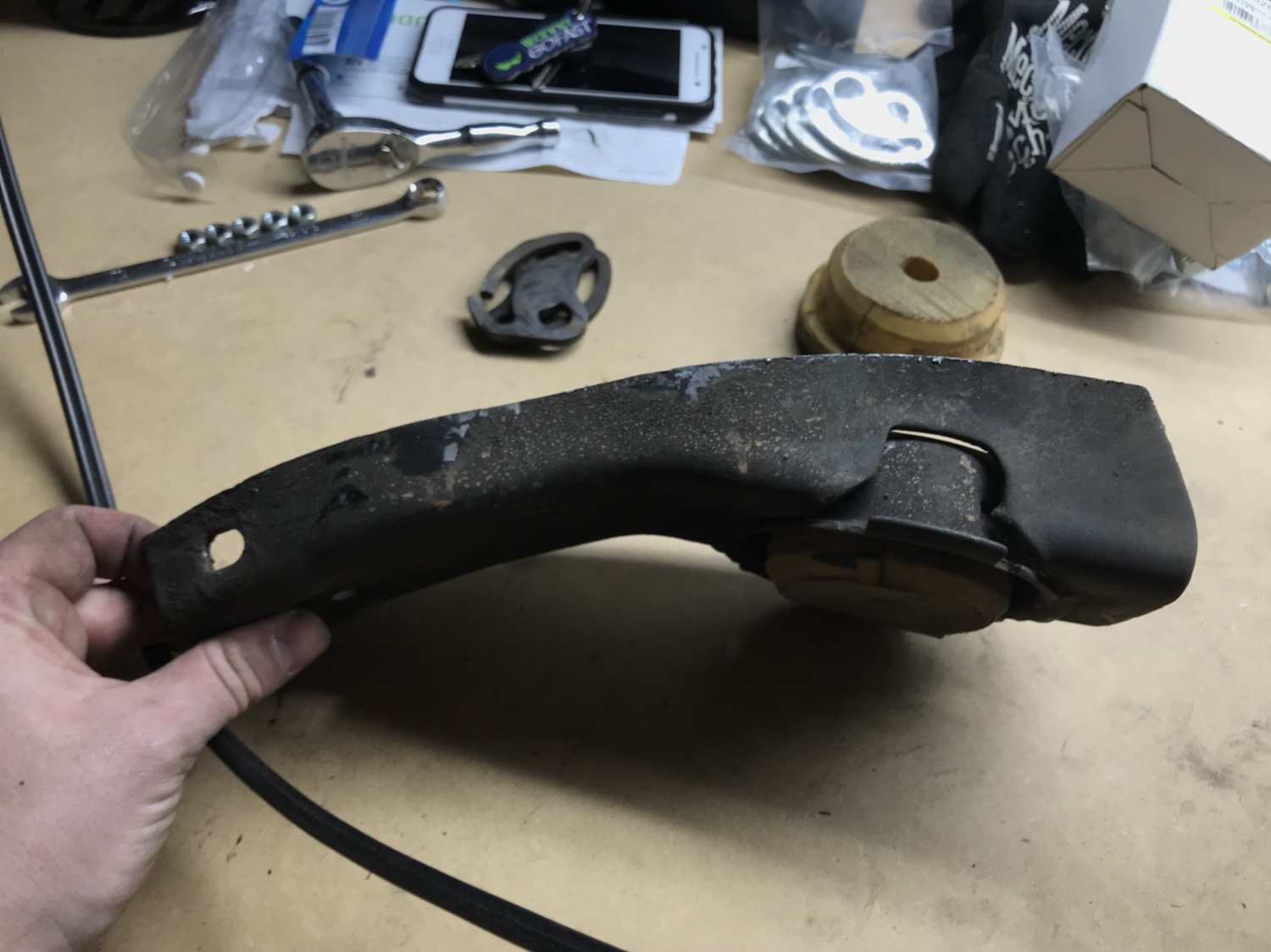

Started here, after fighting the spindles yesterday evening. The finally came off with a bigger hammer
Broken cam on the drivers side
Front went back together pretty smoothly

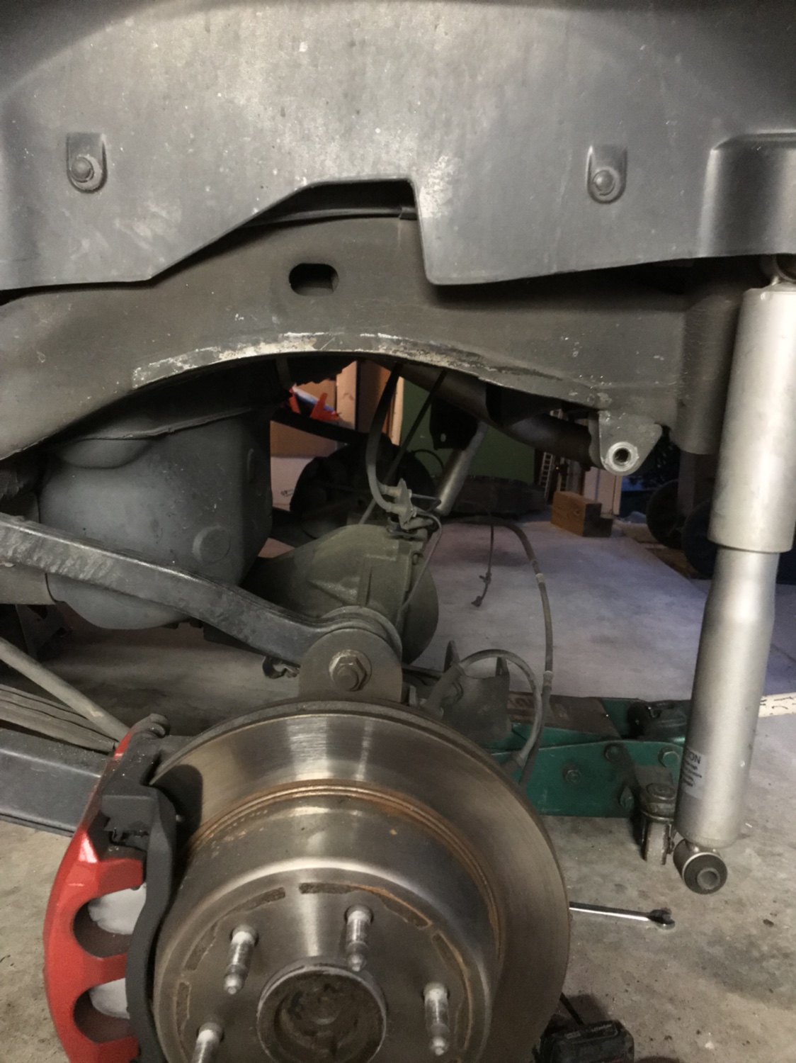

Before free travel mod
During, my buddy Tony (some of you guys know him as b005ted from other forums) cleaning up the cut
After

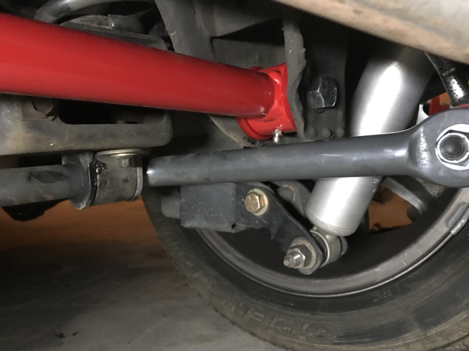

Brackets

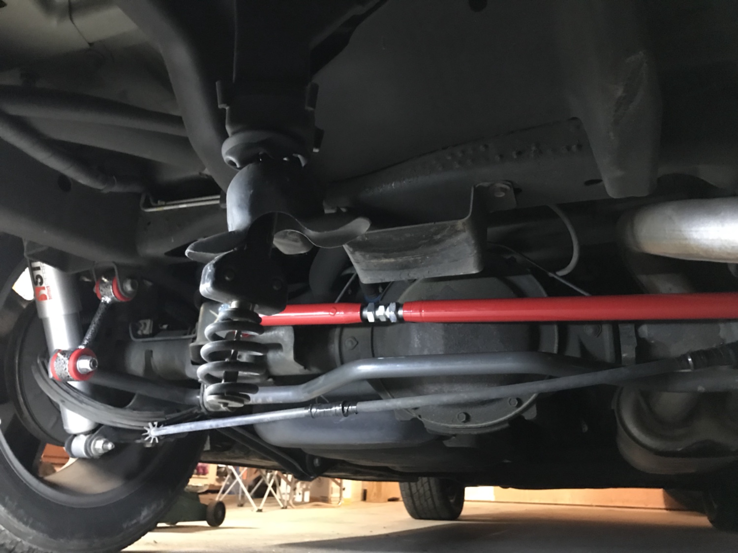

Panhard bar and new sway bar endlinks
Unfortunately the sway bar really does have to be relocated to the passenger side. The passenger side panhard bracket sat hard right on the sway bar

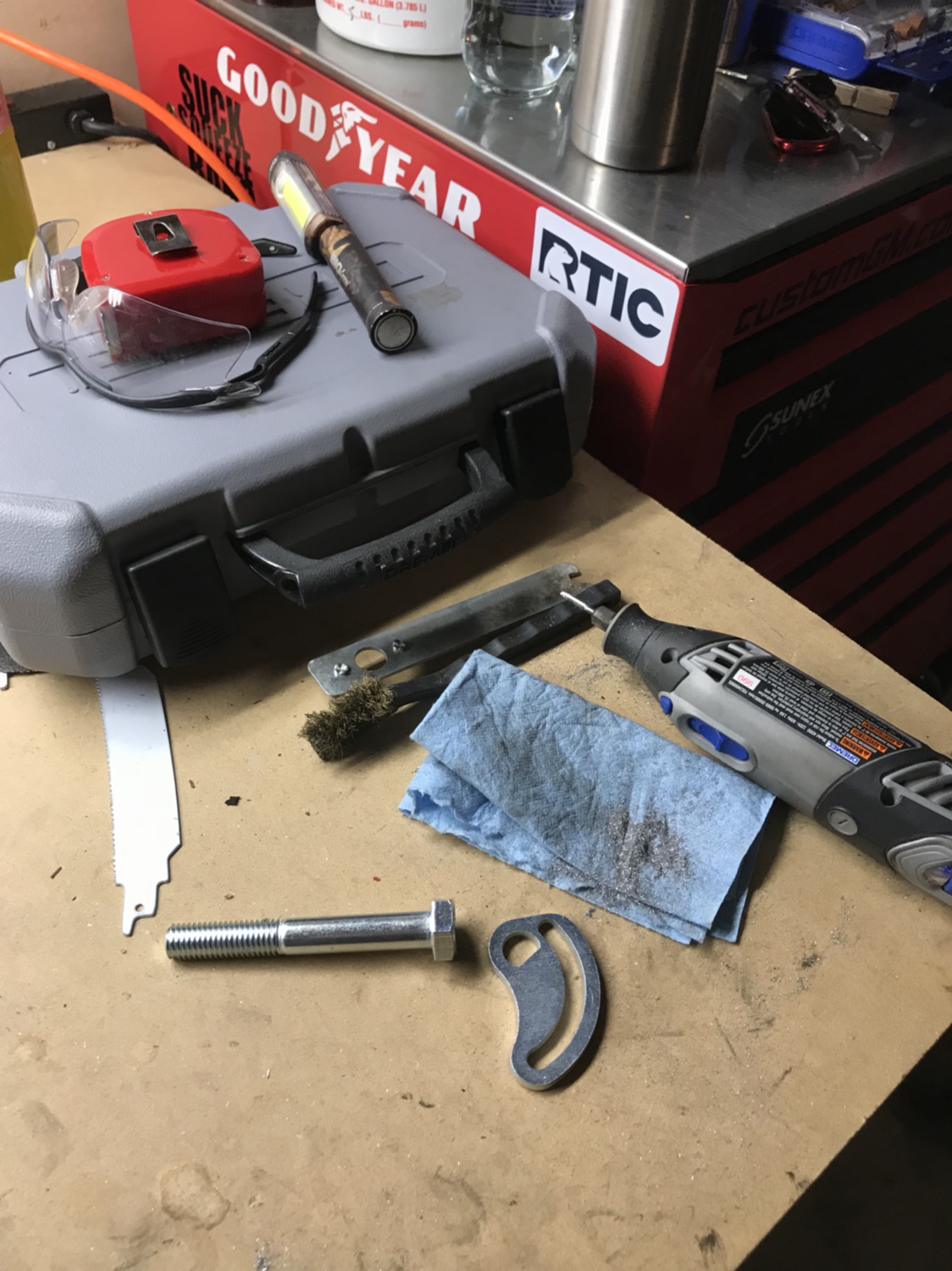

Finished the night off porting and polishing my new Belltech alignment cams. They didn’t freaking fit on the bolts!

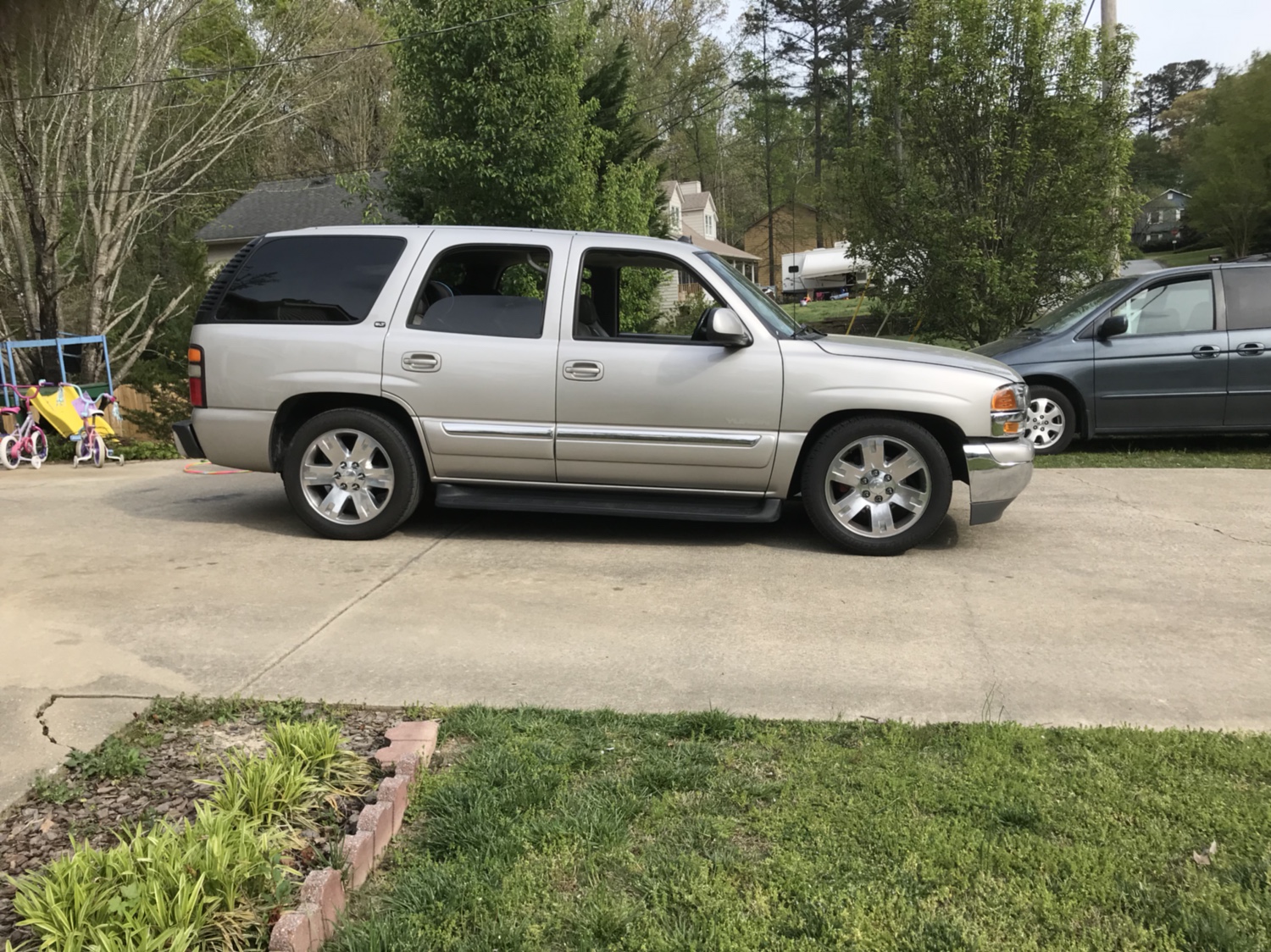

Getting an alignment in the morning, MIGHT mod the rear sway bar if I have time, throw in the spare tire (to weight the rear down) and see if I like the rake. It’s sitting at ~27 1/8”-27 1/4” up front and ~28 in the rear. Not sure how I feel about the rake, may cut half a coil eventually

Brackets

Thanks man. I guess I should clarify, that’s measured at the front (just behind the front tire) and rear (just in front of the rear tire) on the body line. The wheel wells aren’t even on these trucks so I don’t measure there
