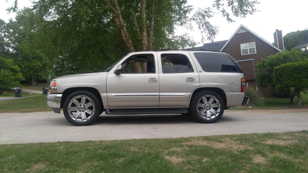

So I bought these 22s from a guy that said "I accidently used some mag wheel polish on these and messed the finish up". I originally thought it was just stuff caked on top of the clear. Tried buffing them today and it's not. I burned through a small spot in the paint with just rubbing compound on a power cone :facepalm:
Pretty bummed, but I only paid 900 and they have brand spanking new tires on them so even getting them refinished, I'll be in them wayyy less than buying everything new. So for now they're just sealed and I put the spikes back on. Also buffed my tail lights.
Cannot get over how good this thing looks low

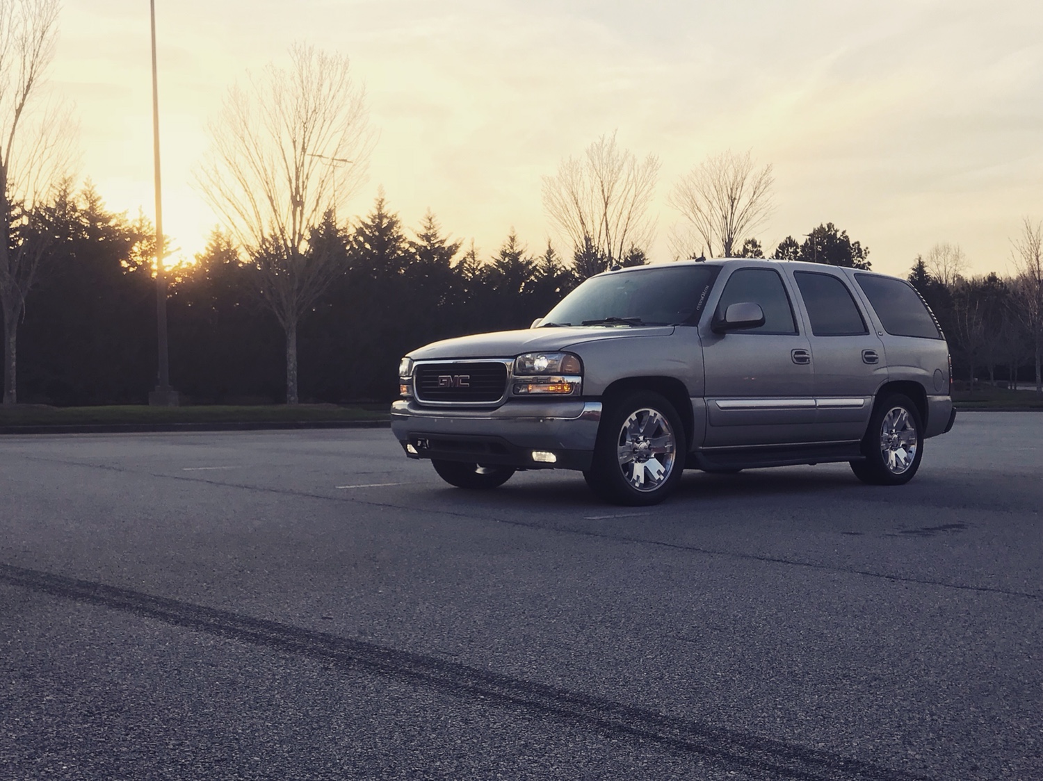

Hey guys, I’ve been gone for a long time, not even lurking cuz the past year has been crazy. Saving for our first house, changing jobs, buying a new house, getting the kid’s schools changed, wife changing jobs and life happening haven’t left much room for mods. But I’m finally able to play a little bit again.
The truck is still sitting 2/3 with decranked stock keys and Belltech 3/4 coils and Belltech sway bars but I sold the 22s cuz it rode so bad with all that sprung weight. I did take off the roof rack though.
Need to grab some Allen key set screws to plug the holes, the stock bolts stick wayyy too far up

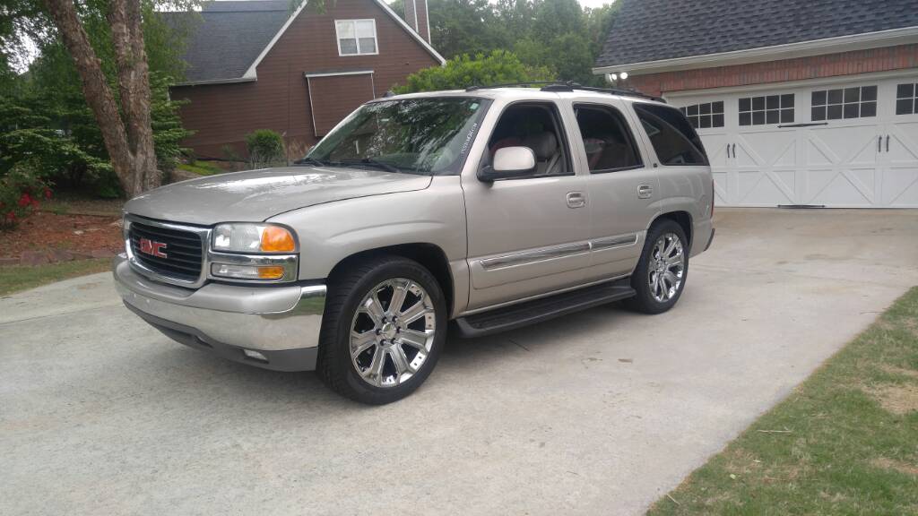

Also sold the 22s last year to help with the house fund plus they rode like shit. A buddy of mine has an 06 Sierra that’s been 4/6 dropped for the last 4 years but he wanted to change it up and lift. So he offered me his polished GMC 20s and almost new 265/50/20 Toyo STs for a song and I also got my spike lugs back from him
