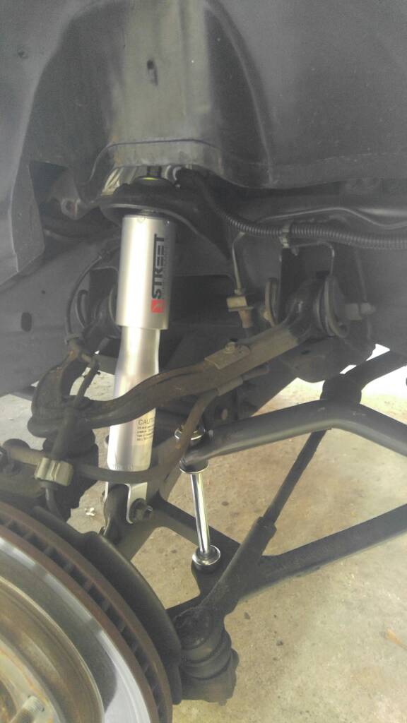

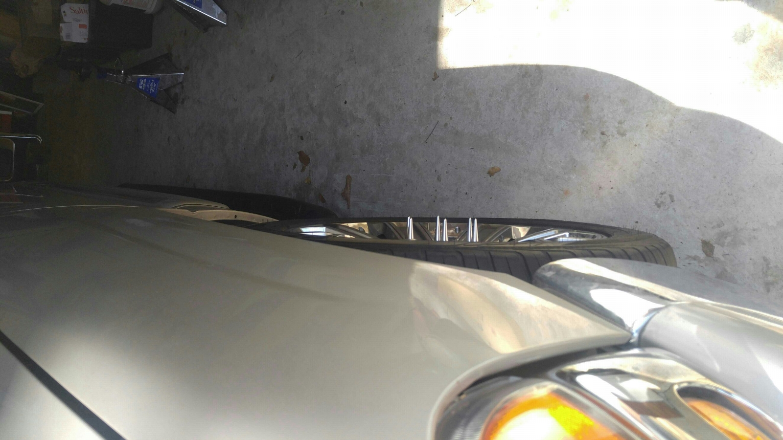

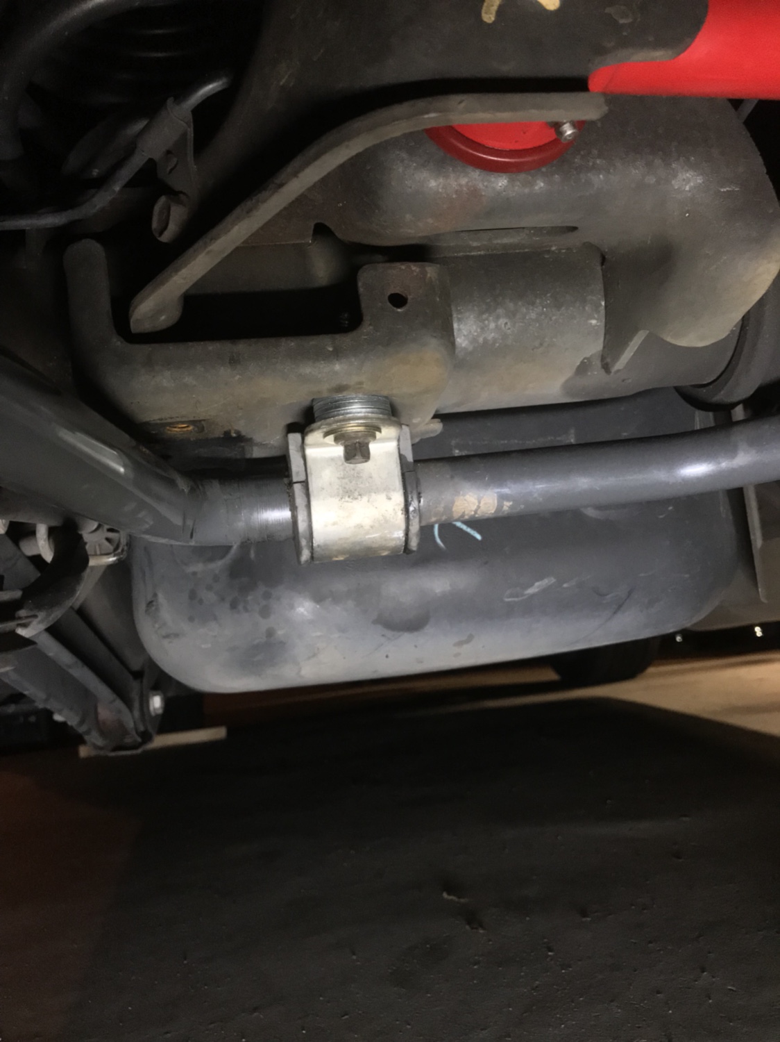

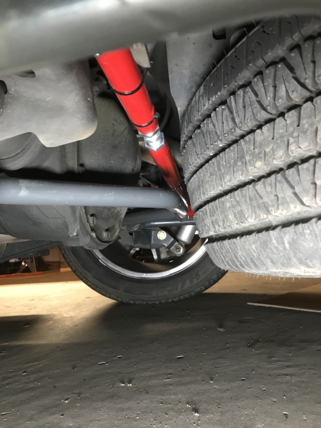

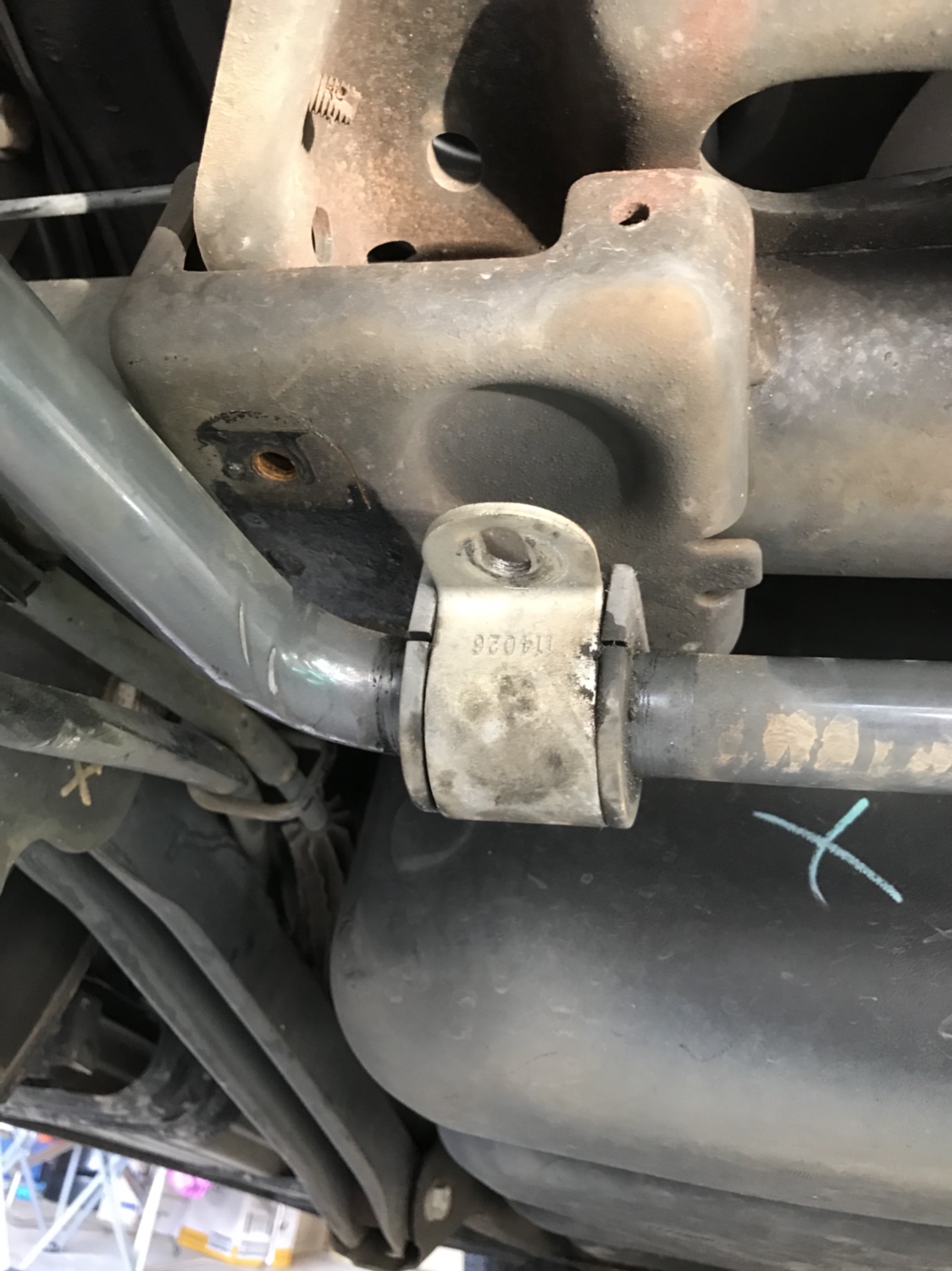

Halfway done. Gotta do the front now

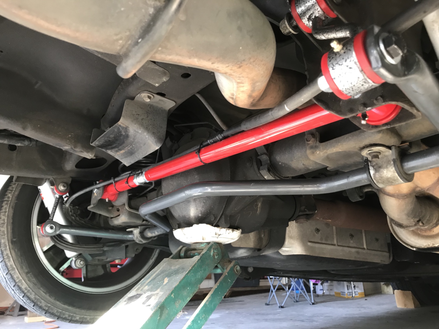

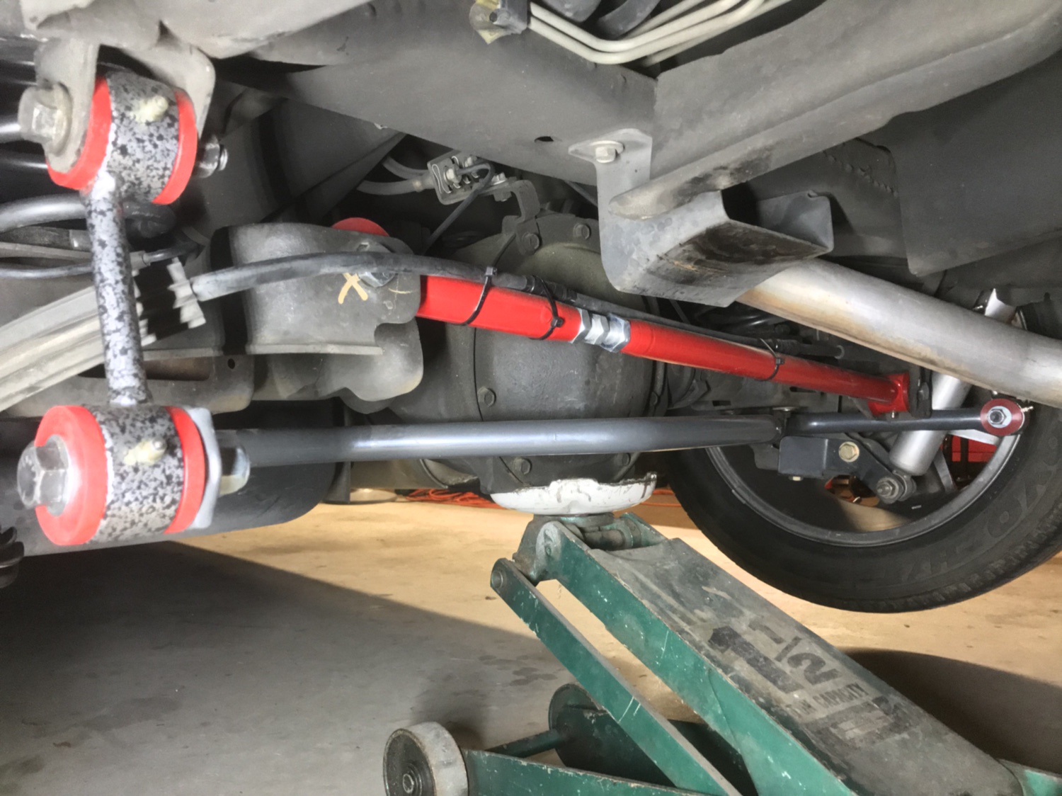

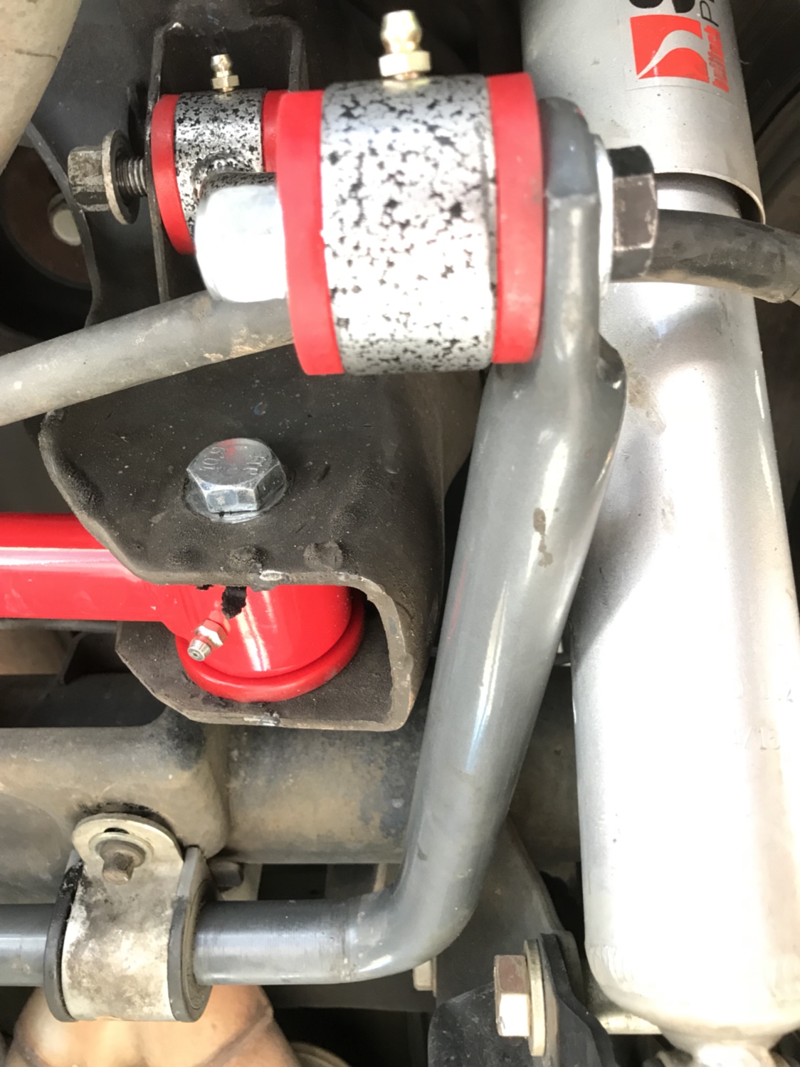

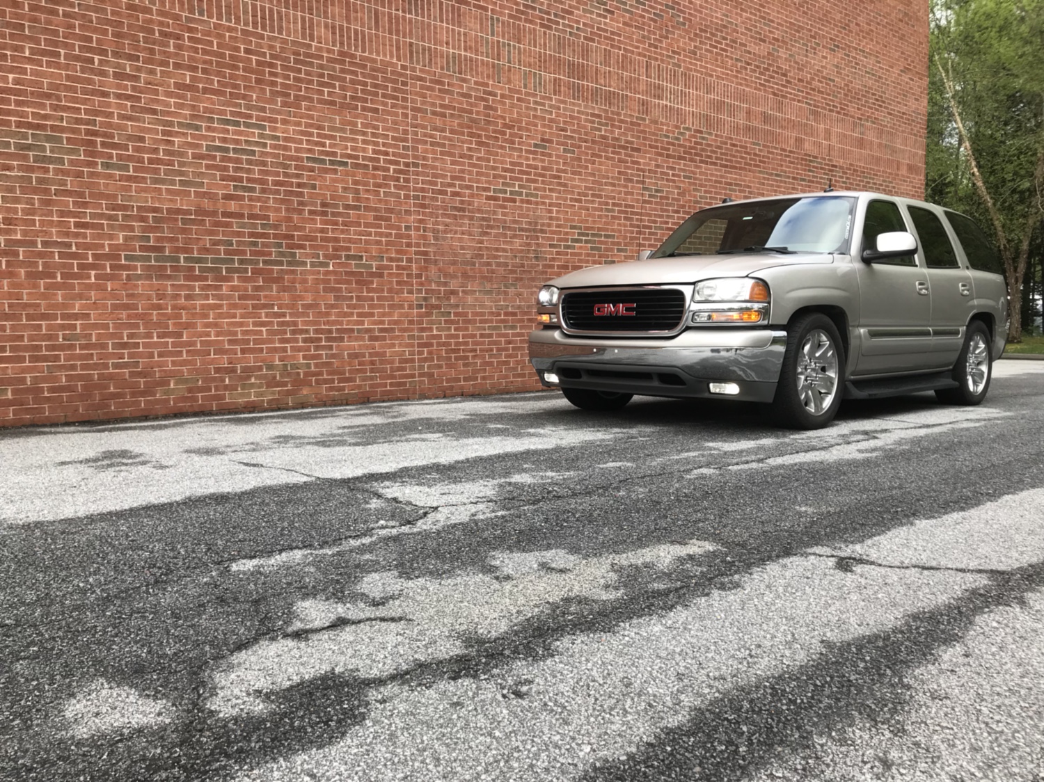

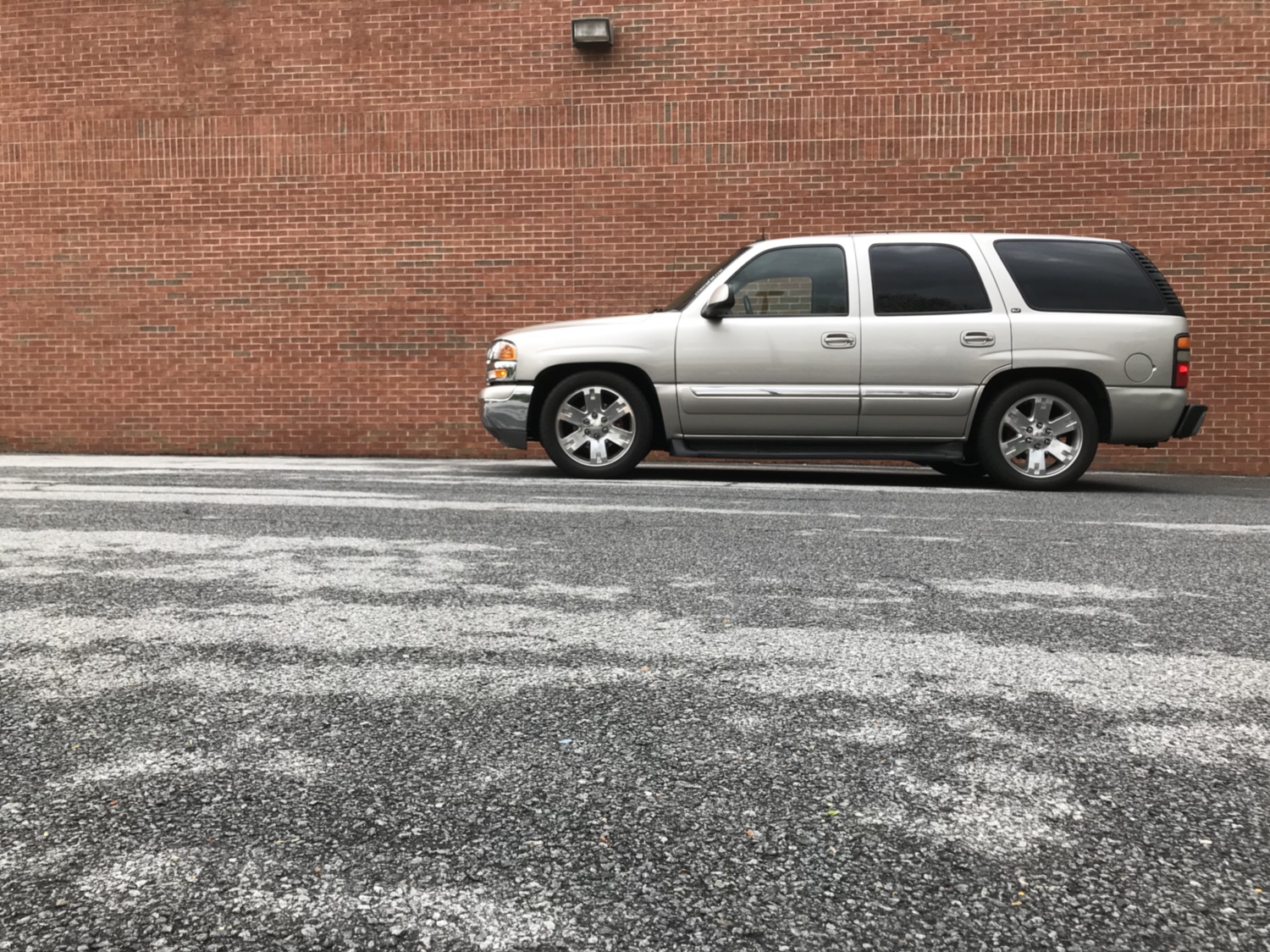

All done, got an alignment set up for tomorrow at 9am. Other than camber though, it drives perfectly straight. I love this kit, perfect match with the 22s. Rides almost stock, VERY minor scrubbing in the rear (where the inner fenders jut out for hardware clearance) and it handles like it's on rails with the Belltech sway bars.
I actually didn't use the drop keys, I just took the bolts out with the stock keys, used the supplied 1" spacer and used the stock isolators. I'm going to pull the isolators at a later date though because the rear could stand to come down another 1/4" or so IMO.
To recap, 2/3 Belltech using decranked stock keys, Belltech rear springs/shock relocators/bumpstops, Belltech SP shocks, Belltech front and rear sway bars, 22x9 GMC 22s with 285/45/22 Toyo Proxes STs.
