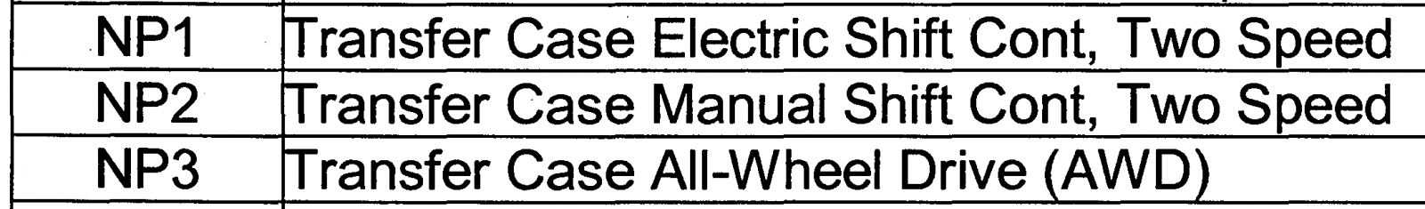

Get us a pic of the transfer case circle plate and it will verify transfer case model and it will also tell us the year model of the donor vehicle too. Pics of the plate of the donor vehicle and the plate on the Tcase thas was in your vehicle originally. Also your RPO code that starts with a NP will tell us what is supposed to be in your vehicle from the factory.

If the Tahoe still has its glovebox, get the "N" RPO codes off the sticker.
Not sure that model exists:
