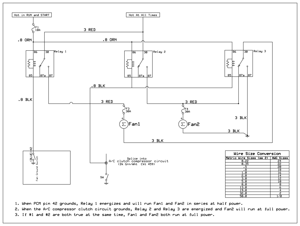

The power wire is bolted to the red power block and the ground hooked to the power bracket. The #42 pin is inserted into the PCM and the A/C wire is connected to the power wire under the hood fuse panel as posted in Post # 1 of this thread. The green wire I connected provides a +14v when the truck is running and AC is on.

Got it figured out!! Both fans work as direct wired to battery. Checked all the wire leads and verified all had the correct voltage. When chasing the wires I discovered a bad relay or stuck relay. It was humming and would not close the switch to activate the ac fan on high. I tapped the relay and got it working. Also I grounded the Pin #42 and activated the temp driven fan. Hope this helps other people out. Also attached is a wiring schematic for the fans.
