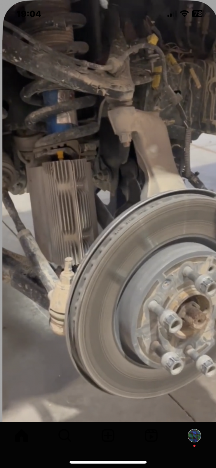

I put ZR2 shocks on my Yukon - need advice
stab6902
Oct 6, 2023
16
I understand that you were able to get the shocks at a fair price, but my primary question is, "Why?"
What is your goal with this Yukon build?
The ZR2 shocks are Chevy's answer to off-road racing. They are certainly a stiff ride. They already netted you 2-3" ride height increase. Don't forget, you're not really changing the suspension travel distance at all just by installing new shocks. You're still riding on the OE magneride coil up front and rear. I imagine it rides much harsher than it did with the OE magneride setup and 2" front spacer.
If you're installing off-road shocks, then why would you want to lower the LCAs? That's already your lowest point of ground clearance to begin with; assuming you've already taken care of the front air dam.
Before you spend any more time and $, I would heavily consider what the overall goals of the modifications are. You could get a respectable leveling kit with brand name coil-overs and UCAs for perhaps cheaper and installed faster than you could/will spend getting the ZR2 shocks to work. And, IMO, the ZR2s will never ride "comfortably" on the Yukon unless you're doing 45+ mph on a gravel, bumpy road...

How much physically longer are the ZR2 struts vs your OEM Yukon ones?
The ZR2 is 2" taller than a standard T1 pickup, not sure what that equates to in Yukons. I can say my '19 T1 1500 with 2" taller suspension (Bilstein 5100's for a Trail Boss) sits noticeably taller than my wife's '22 Yukon 4wd. Both are taller than the previous generation trucks/SUV's. So I wonder if you're trying to wedge a much taller strut into a smaller space and that is causing this issue? A 2" level strut on a T1 is probably more on a previous generation truck/SUV.
stab6902
Oct 6, 2023
16
The ZR2 rear shocks measure 25-7/16" fully extended and 16" fully compressed (measurements taken from center of mounting holes). The front struts measure 22-7/8" from the top mounting surface to the bottom of the lower mounting stud.
Unfortunately I do not have K2 parts in front of me for comparison.
I think there’s the problem. I was just digging around on RockAuto and every front strut for a ‘16ish Tahoe/Yukon measures about 17” extended.
The rears are about the same as the ZR2 Shocks.
stab6902
Oct 6, 2023
16
Yeah, the T1's certainly have the upper strut mount up higher, and therefore have longer struts for any given ride height.
I think if @Favored has room to bolt the lower strut mount below the A-arm (which supposedly lowers the truck 1.5-2" according to another thread on this forum), he could end up with ~3" lift vs stock, which would allow him to drive the truck and see how it feels.

I’ve made a decision to not go further with the front ZR2 shocks/struts at this time. Likely going to order some Fox 2.0’s for the front and keep the ZR2 rear shocks as they feel great!
