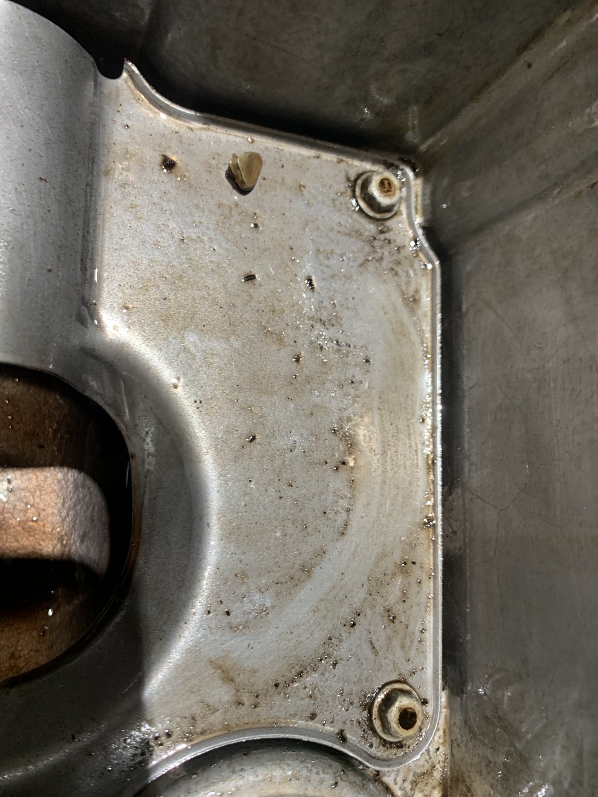

Thanks guys for all the help I really appreciate it. So I just pulled the pan and there’s some metal shavings in the bottom of the pan that I know weren’t there before…along with what looks to be a chunk of silicone gasket material that I’ve never seen before… so on a scale from 1-10 how bad is this starting to look?

huh.. does the metal stick to a magnet? or is it aluminum.
did you find anything wrong with the o ring?
