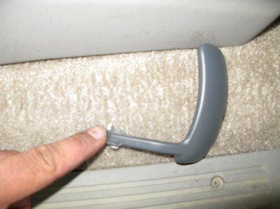

It's the inner door handle itself. We replace a least 2-3 a month on the Chevy trucks at my shop. The handle is potmetal and stretches after time. It will eventually just snap off like Tahoegoboom said. Replace the handle and also look at your pins and bushing on the door hinges. Many times the bushing are going out so the door is mis-aligned and you have to work harder to open it. Hence pulling harder on the handle and streching it more.

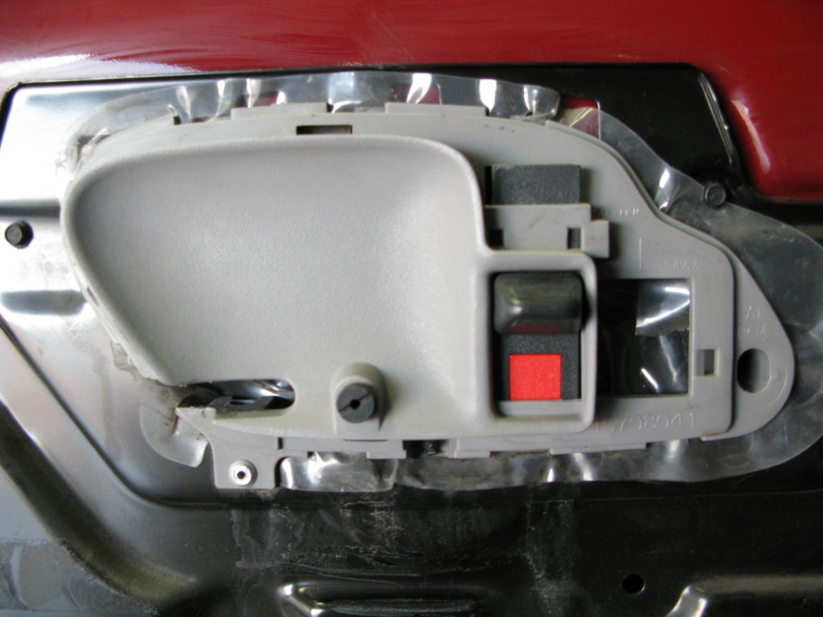

No problem. Inner handle is rivited in place so be prepared for that.

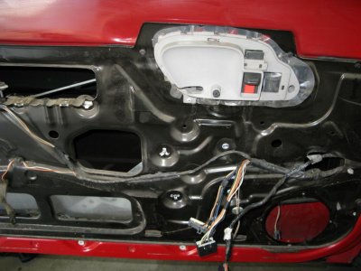

Ok pulled off the door panel tonight.
Replaced mirror too.....AND lost my friends swivel socket inside door frame somewhere:emotions122: What a damn pain....

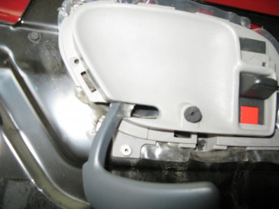

Ok - so drill the rivet BUT HOW do I re-attach? Self -tapping screw?
AND what about that other thing to right of rivet - see pics....
As you can see - cheap pot metal handle broke....
