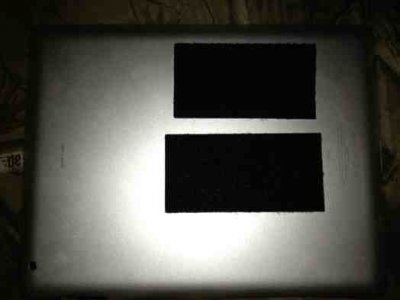

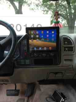

I went and bought a big peice of acryllic plastic at the local arts and crafts store here in japan, and then i cut it with my dremel tool to the approximate dimensions i was looking for on my dash. After that, i have this little blowtorch type thing that my wife uses to make creme brule and i used that to kind of melt the plastic so i could form it to the shap i wanted. If you do this, dont get the flame directly on the plastic or it will catch fire or bubble up real bad. Once i had it bent the way i wanted it, i put a strip of velcro on top of the dash right above my stereo and then a piece underneath the top part of the plastic peice i made. Sorry, i dont have a pic of that part. After that, i put a few pieces on the front part of the plastic and thne a few more on the back of the ipad that way it lines up just right on the plastic piece. This thing is sturday as can be and it actually sits pretty flush with the dash. It really doesnt stick out at all to where it can be annoying.
I connect it to my stereo via bluetooth so there are no wires anywhere, which is pretty nice. Not bad for a little bit of redneck ingenuity....
