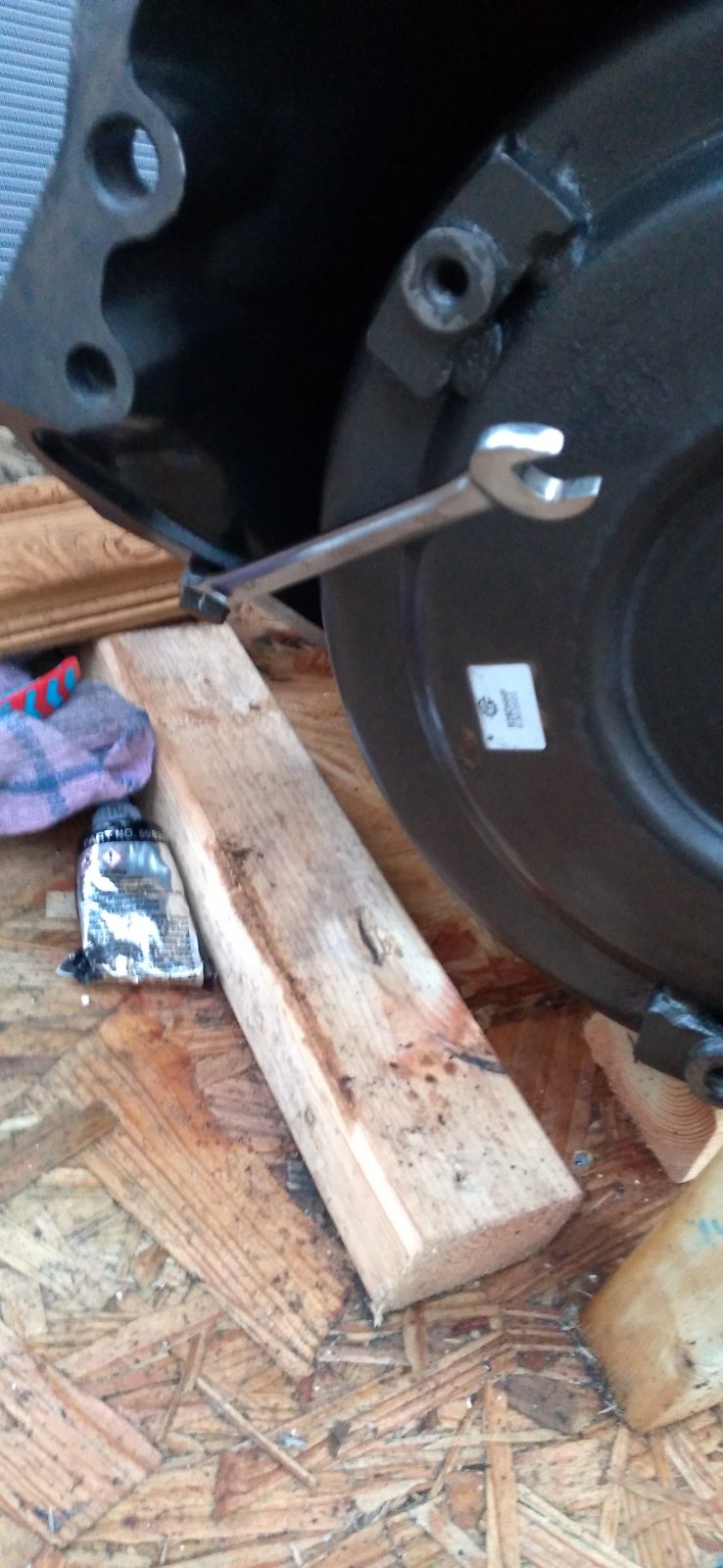

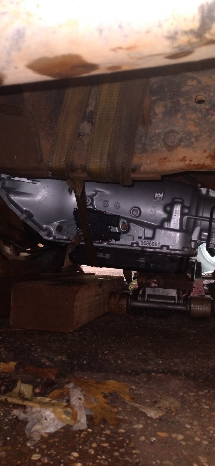

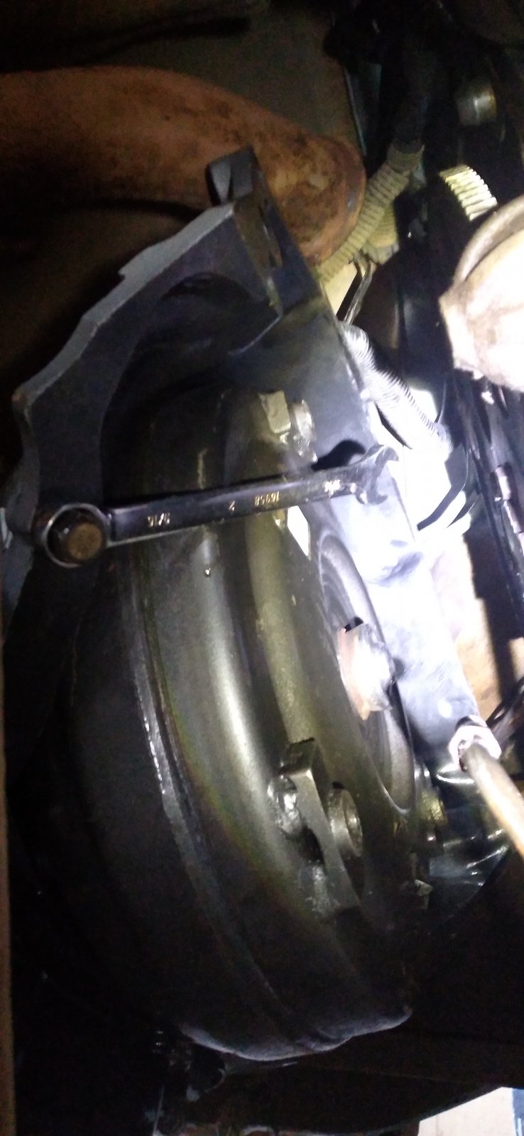

The trans is ready to install. Filled the torque converter with 2qt. atf, installed new gear range indicator/neutral safety switch, verified the harness plug has 13 pins like the old one, fluid fittings in & out are sealed & tight, output flange & shaft match the removed unit. Here is a trick I like to use. Put a wrench against the torque converter do it stays put until you are ready to mate the bell housing to the engine. Use a hole on the t/c cover flange and it doesn't interfere with getting the gearbox in place!
