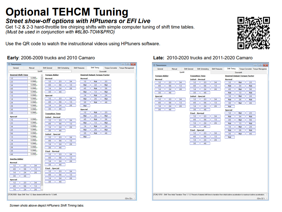

Is there a way to tune the transmission to shift faster/more responsive?
transgo has a kit to help the 6l80 shift faster, and they include some tune details to adjust the shift time.
they also require the install of the larger boost piston in the kit.
What sucks is i have everything except for the larger boost piston, i have the transgo boost piston, but I don't believe it's the larger one.
the new kit came out a few months after I rebuilt my transmission. :confused:
I'm tempted to play with the settings anyways to see how it acts.
and the settings are for hptuners.
Link: https://transgo.com/product-details/6l80towpro/

Kit instructions are on the site, but here is a snippet of the page.
