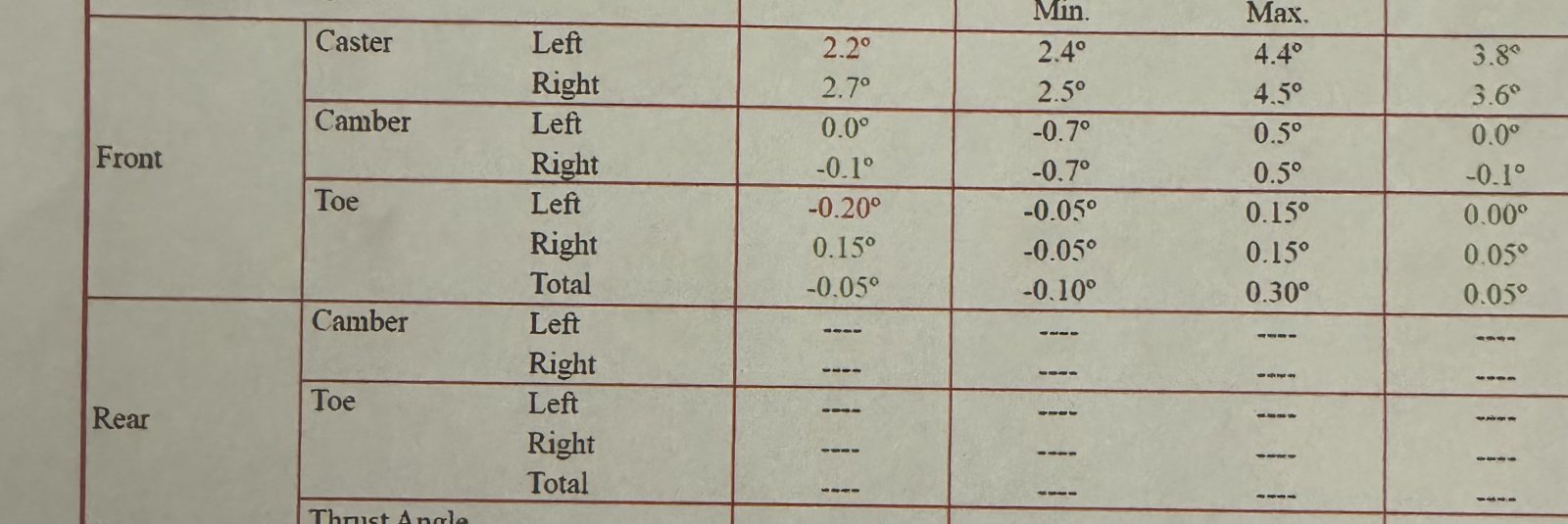

I'm attempting to tackle my steering issue but wanted to see if any others have experienced anything similar before I start firing the parts cannon at it.
At its core, I have very little steering resistance. You get used to it after driving for a while but the second I go to one of my other cars, its extremely noticeable. While I don't have very much play in the steering wheel and there is no drift while driving, when I go to make a turn the wheel has almost no resistance to return it back to center. After extensive research, almost everyone claims this is related to alignment. I have had 2 alignments post my front suspension rebuild without any improvement. Since I have replaced upper/lower intermediate steering shaft, UCA/LCA, front struts/springs, inner/outer tie rods, sway bar links/bushings all that is really left is the power steering pump and rack and pinion. I've also read that the steering angle sensor might be a culprit but I have no DTCs that would indicate an error.
While the alignment shop seems to think it is the rack I wanted to get some input before dropping the $500. There are no leaks on the rack but there is maybe a quarter inch of play of it moving in/out when I jack up the front and move a tire left/right. I did have to replace the power steering high pressure hose, due to a leak, which also could've caused an issue with the pump but it still feels relatively smooth (no whine) when I need to make a turn...its purely the lack of steering resistance to bring the wheel back to center. I don't believe the pump plays a role in providing the steering resistance/return to center but maybe I'm wrong.

Quick update: I talked to one of the rack manufacturers on the phone at length. They seemed to think it is alignment related, not rack. I'm going to eventually take her up to a different shop and use @Marky Dissod recommendation on specs and see if it makes a difference. Will update once I get around to it!
